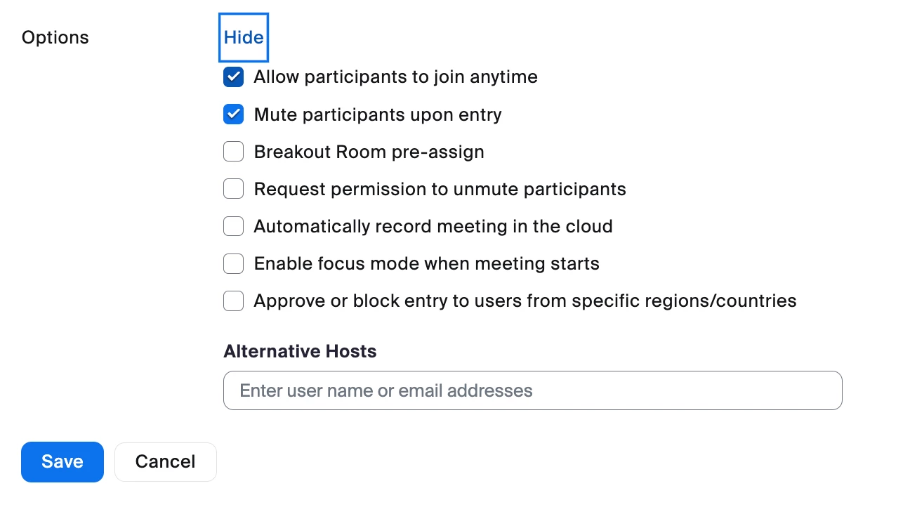

You are specifically using "Zoom Room" to describe a hardware-based conferencing system that exists in a conferencing space, correct? Just want to be sure before providing additional steps, as it seems like you may be using "Zoom Room" to describe a "Zoom Meeting".
For ANY Zoom meeting (including those that Zoom Rooms are invited to), you can allow participants to join before/without the host by navigating to zoom.us->Meetings->[Schedule / Edit the given meeting]->Options->Show->Allow Participants to Join Anytime

To set up a Zoom Room that's always on:
  1. Enable "Join Before Host": Go to your Zoom web portal > Settings > Meeting > toggle on Join Before Host. This allows participants to join and leave without you.
  2. Use a Recurring Meeting: Schedule a recurring meeting with no fixed time under the Meetings tab. Share this link with members for continuous access.
  3. Set Up Zoom Room Kiosk Mode: Ensure the Zoom Room device is configured to stay active and not sleep, and enable Auto Start Meetings.
  4. Disable Waiting Room and Passcodes: Make sure the Waiting Room is off and use a simple passcode or none if security isn’t critical.
