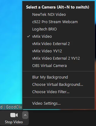

    Switching Between Two Cameras on One Zoom Login
    Click the ^ next to Start or Stop Video icon, and see the list of cameras.  All available cameras will be shown there.  Here is a screen shot of my list of cameras, which is much longer than most:
    You'll see the check mark next to the currently selected camera.  When you want to switch from your stationary camera to your roving camera, simply select the camera that you want, and the video from that input will now be displayed in your attendee camera view on Zoom.  Your list of cameras will most likely be shorter than mine, but you should see all available cameras on your system in that list.
    If your remote attendees will be viewing this camera as their primary view of the current speaker, I like to do 2 things:
    1. I like to rename the Zoom display name to something indicative that it is a live feed from your onsite location, something like "Live From The Classroom" or "Live from New York".
    2. I like to Spotlight the camera so that attendees in a meeting can switch between Speaker and Gallery view, and Speaker View will always be showing the "Live" video.

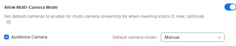

    Assuming this is a Zoom Room, can't you just turn on Multi-Camera mode? (Room Management > Rooms Profile > Devices)
    We have a presenter camera and an audience camera. The room audio is tied to whichever is set as the default main camera. We have to change this manually during a meeting if we want the camera to highlight the audience when someone is speaking. Anyone watching in gallery mode can see both cameras.
