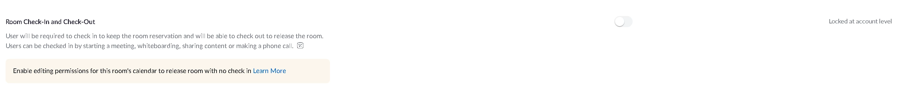

Room Check-In and Check-Out remains gray

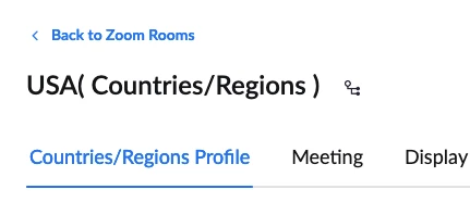

I have reset this function in all hierarchy levels (floor, building, city and country), it means the account setting should affect all rooms.
In some rooms this function is not active and cannot be changed.

    I have the same question as you.  But it doesn't work in any rooms. They are all grey under the room settings.
    I think this notice is useful for us"Enable editing permissions for this room's calendar to release room with no check in" But I don't konw how to do it. How to enable editing permission?  Is that mean the integration account need some privileges?
    Hi @Rick-Pony ,
    if it's not locked in higher levels (Floor, Building, ...), it can be the account htat you give in "Calendar Integration" doesn't have the right access to the room's calendar.
    Give the higher access, reauthorize, after some hours it should work.

     When you go to Room Management > Zoom Rooms > Account settings > setup > is the Room Check in and Check-Out locked by the admin here? (Screenshot)

    thank you for your answer but it still doesn't work.
    It was off (unchangeable) and unlocked, now It is off and locked. 😐  (Screenshot)

     You know that you can go in to the main Zoom Room settings, or you can go into the location settings like I did below for my testing account for Zoom Rooms. Check in all locations. It has to be locked by either an admin or owner of the account for it to be greyed out by another member.

    This setting in all the higher levels is active and not locked.
    It means that it should be inherited (activated) and be changeable, but it's not.

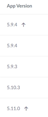

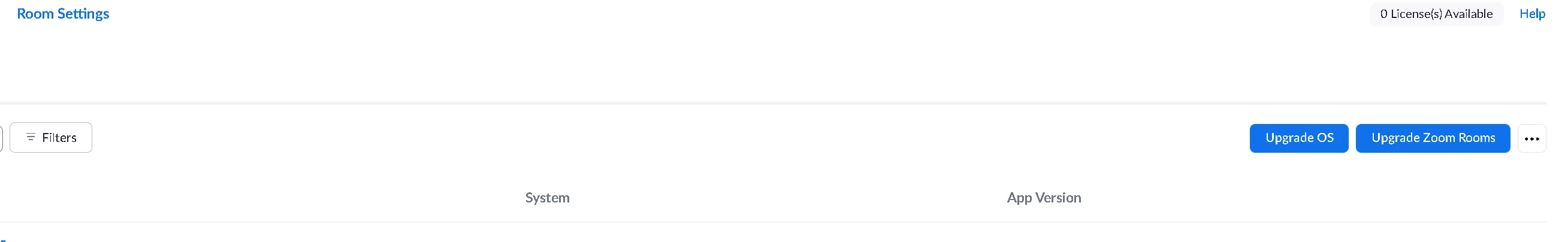

    @Rick-Pony @YaBoiB All my rooms are now editable.
    I don't know if it helps or not, but i upgraded rooms and OS too.

    That means your rooms check-in and check-out feature is working now? So what role you give to the integration account?my APP version are all later than the minimum requirement.

    Hi @YaBoiB ,
    the account that we gave in "Calendar Integration" didn't have the right permission to the room's calendar.
    upgrading isn't important.
