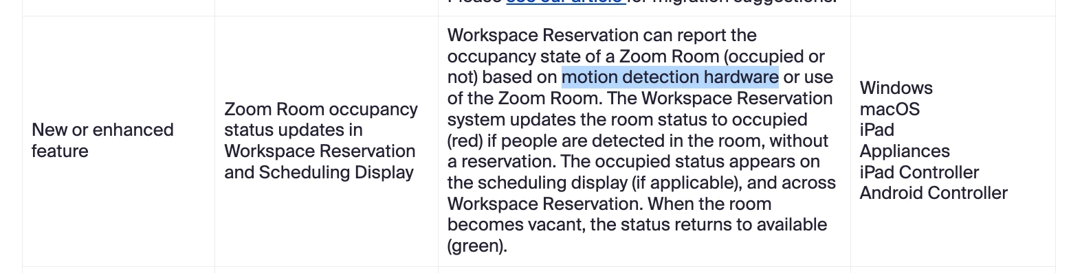

Regarding occupancy status, ostensibly there is a supported hardware list somewhere (source - release notes for Rooms):
However, the admin portal says only the following:

Coming back with a few data-points.
  • Occupancy sensing must be configured at the Workspace level (not Zoom Rooms level, even if the 'workspace' is just a Zoom Room).
  • When configured and compatible hardware is used, room status will change to 'Occupied' on its respective scheduling display when people are detected in the room, which differs from 'Busy'. We have only tested with Android appliances - Neat Bars, Logitech Rally Bars, and a variety of AOSP scheduling displays.
  • People counting may be used in conjunction with occupancy sensing, but people counting may remain disabled for the ZR and occupancy-sensing/reporting will still work. Not a requirement.
