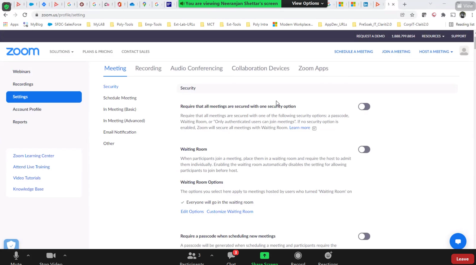

Hi, I have a Poly endpoint Studio-X (running in Zoom mode with firmware 3.9) with Zoom app 5.8.3. When I join a Zoom meeting and share content via HDMI cable, the far-end content share screen has a poor resolution. When I share with the Zoom app using proximity, the far-end resolution is great. I am able to replicate all the time. Is there a limitation on content share resolution on HDMI? How to fix this?
