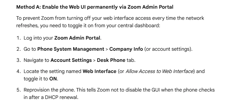

    Oct 14, 2026 7:26 PM UTC
    I also made this change the other day but I still had to reboot the phone to get access to it.  I have tried phones at multiple site today and do not have a problem.
