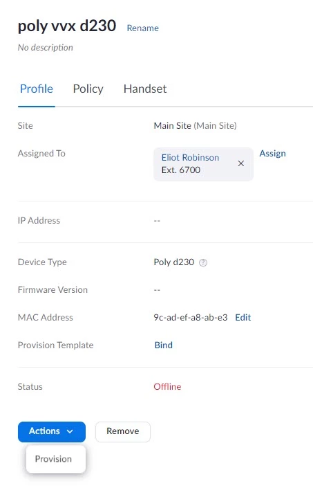

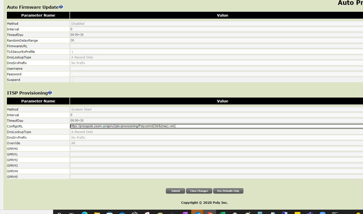

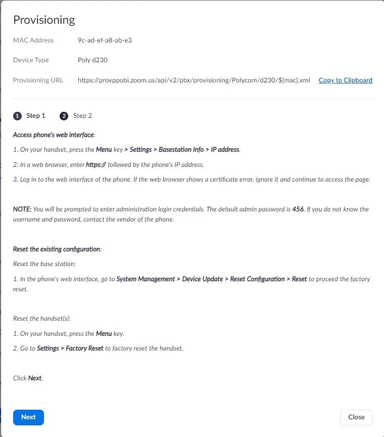

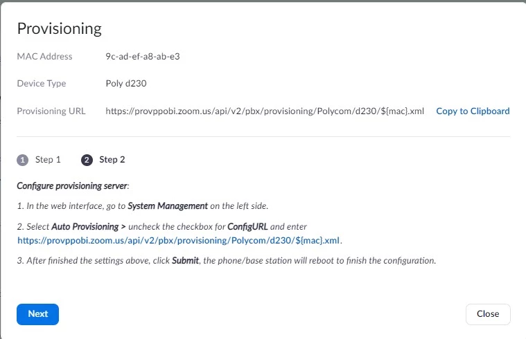

    Eliot
    September 7, 2022
    your provisioning url should be for d230 not vvx250.  when you go to phones & devices>add desk phone, select model d230.
    please see attached screen shots.
