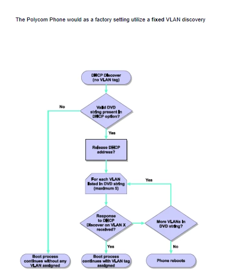

    according to poly support article, if poly phone does not received any vlan info, the phone should continue with boot process.
    Utilizing or troubleshooting VLAN's with Polycom SoundStation IP, SoundPoint IP or VVX Business Media phones

    the flow chart shows if there is no vlan, skip trying to get vlan info.

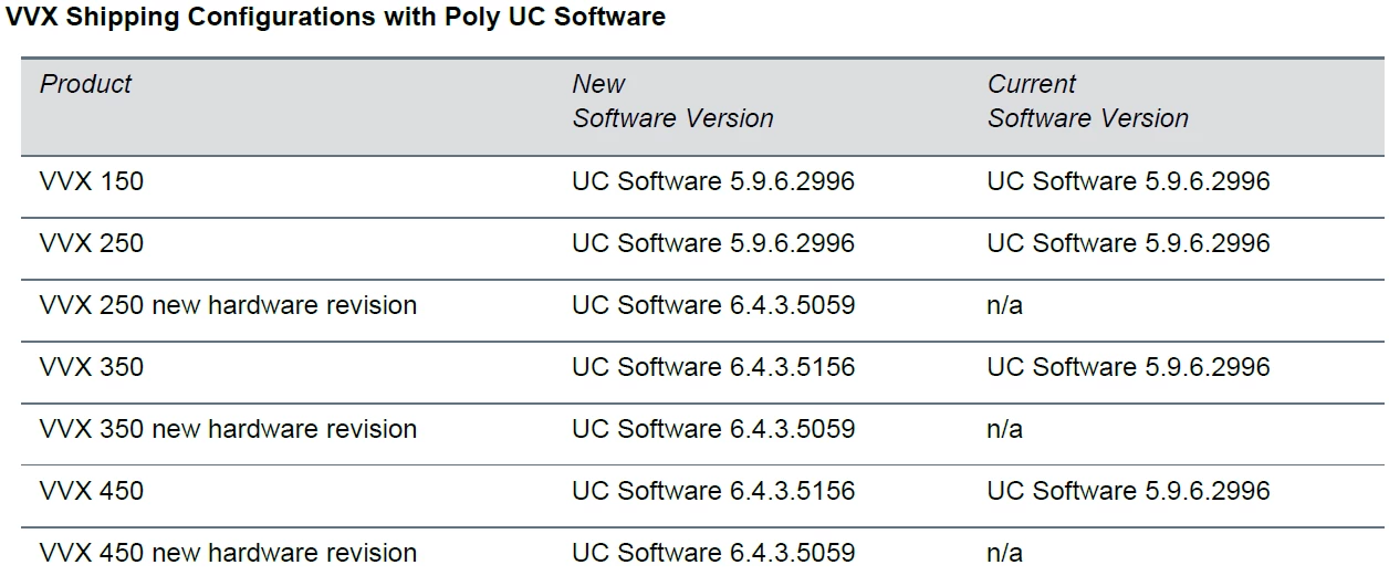

    poly vvx x50 desk phones have a relatively new hardware upgrade that requires different firmware.  maybe the firmware on your poly desk phones is for the wrong hardware.
    my vvx 450 has the new hardware and has firmware 6.4.3.5059. please see the poly config change notice which tells you how to identify poly phones with the new hardware revision and what firmware is required:
    Poly VVX June 2022 Product Shipping Configuraturation Change Notice - Rev E
