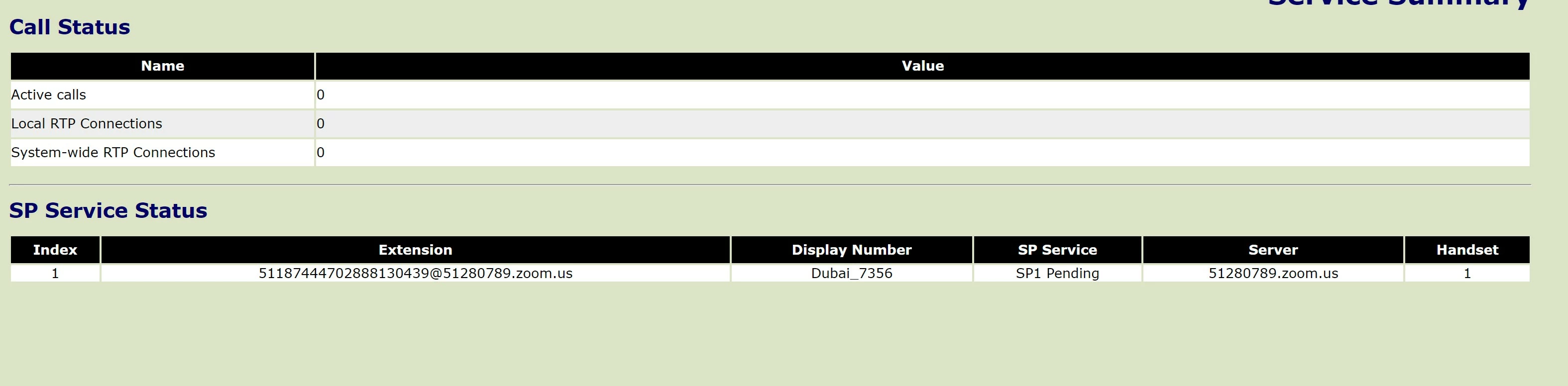

Unable to register Poly Rove b2 / Poly rove 30 under  Zoom Phone
Status showing as
SP1 Service Status : Pending (server=51280789.zoom.us)

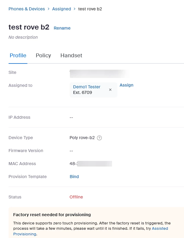

thanks for the screen shot.  the poly rove-b2 status is 'offline' and 'factory reset needed for provisioning'.

after you plug your rove-b2 into your lan, it calls home to poly (hp).  because you have set up your rove-b2 on zoom, zoom has told poly that this rove-b2 is assigned to zoom.  poly tells your rove-b2 to get its provisioning from zoom.  your rove-b2 connects to zoom provisioning server and gets its firmware updated and provisioned on your zoom account.  your rove-b2 may restart a few times as it goes through this process.

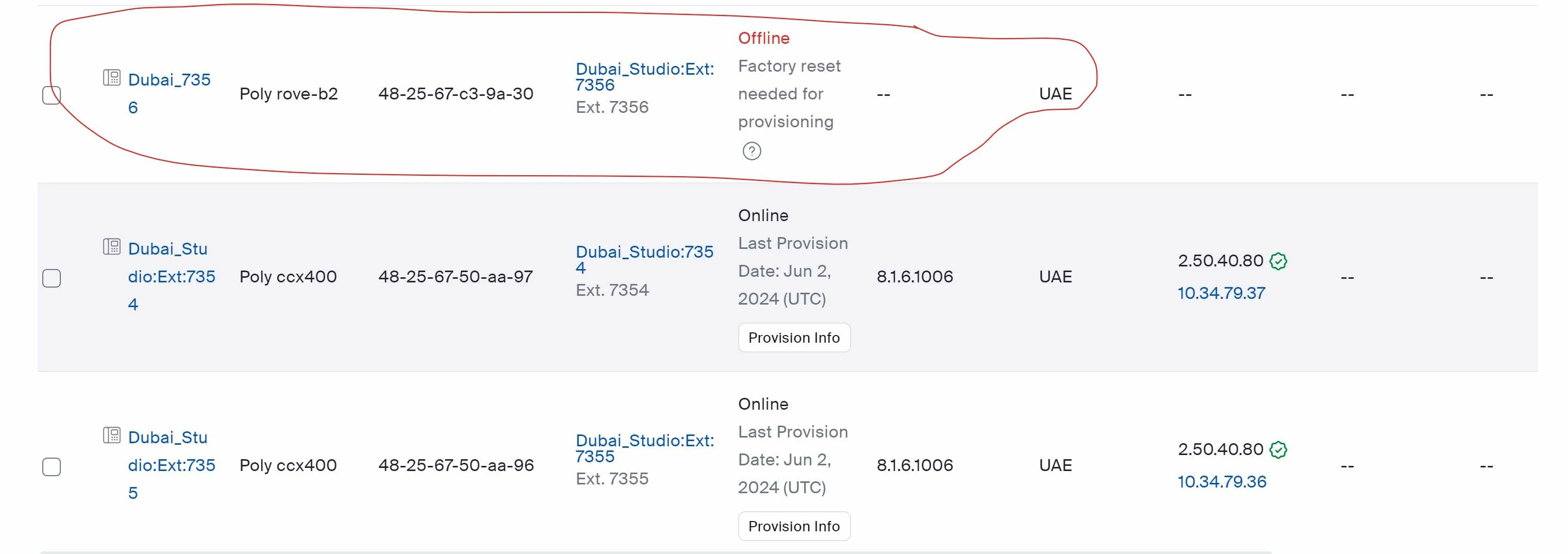

IrshadAuthor
Participant
Jun 3, 2024 10:15 AM UTC
Already did this , please review attached

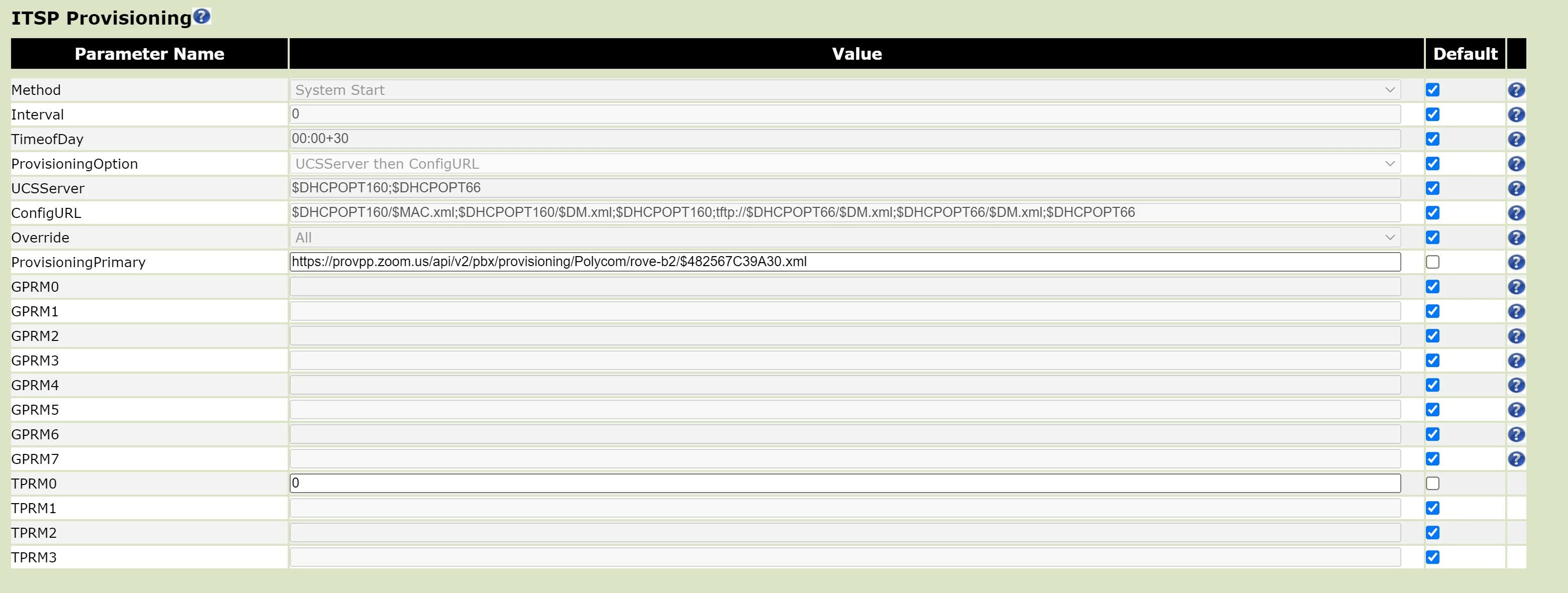

paste the URL as is.  i think i was wrong about replacing {mac} with actual mac address.

These are brand new Poly Rove B2 and Rove 30 units. We also have Poly CCX 400 phones, which are working normally. I have tried the steps mentioned above using both ConfigURL and ProvisioningPrimary, but the issue persists.

i made a mistake asking you to replace {mac} with actual mac address for itsp provisioning.
you should use
https://provpp.zoom.us/api/v2/pbx/provisioning/Polycom/rove-b2/${mac}.xml

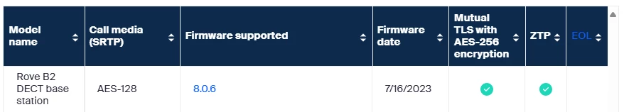

please check your firmware on the base station.  according to zoom, it should be 8.0.6.  sometimes, older firmware will interfer with ztp.  please see hp community article about checking firmware and where to get updates.  with ztp, this should be automatic.
[Software] Poly Rove DECT 8.0.9 - HP Support Community - 9041072
i suggest opening a support ticket with zoom because rove-b2 is a supported zoom phone certified device with ztp.

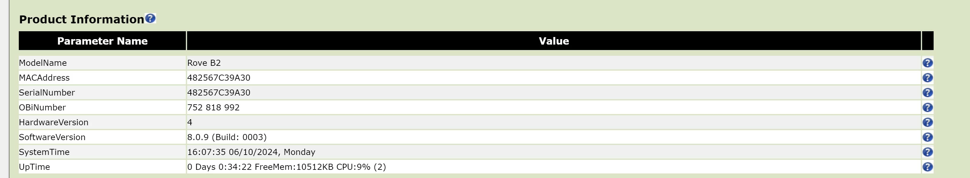

Jun 10, 2024 11:13 AM UTC
Attached is the version in use. I already have an open case with Zoom, but their support is only forwarding the Admin Guide and Troubleshooting Guide, which I have already reviewed, yet the issue persists.
Actions taken so far:
  • Firmware upgraded
  • Factory reset done for base
  • Factory reset done for handset
  • Auto provision and manual provision also done without success.
