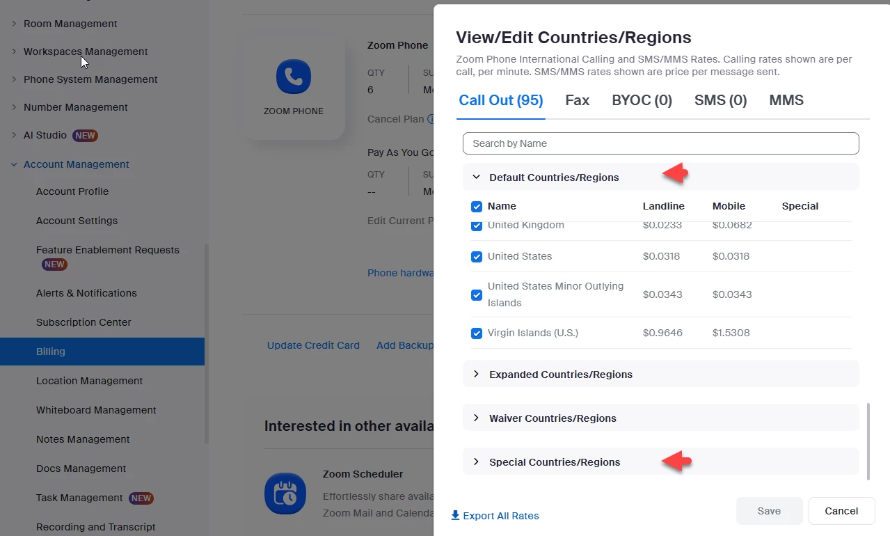

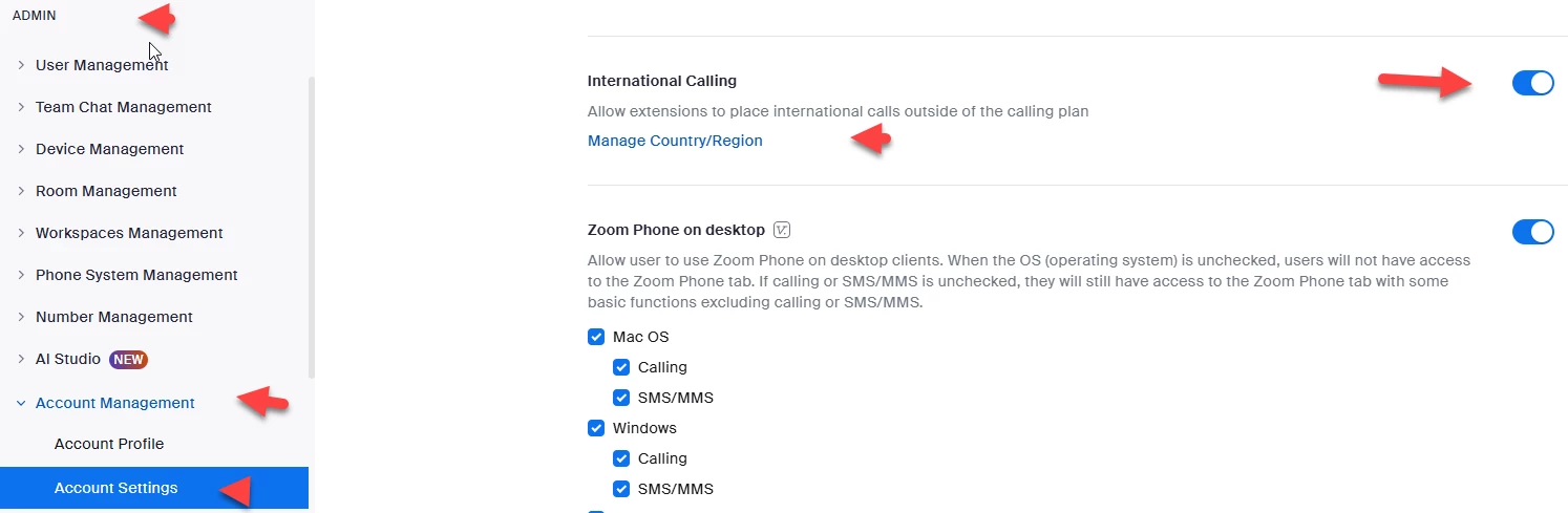

here is a a couple of screen shots:
Enabling or disabling international calling
Turkey and UAE can be selected from the default countries/regions located in account settings->zoom phone.

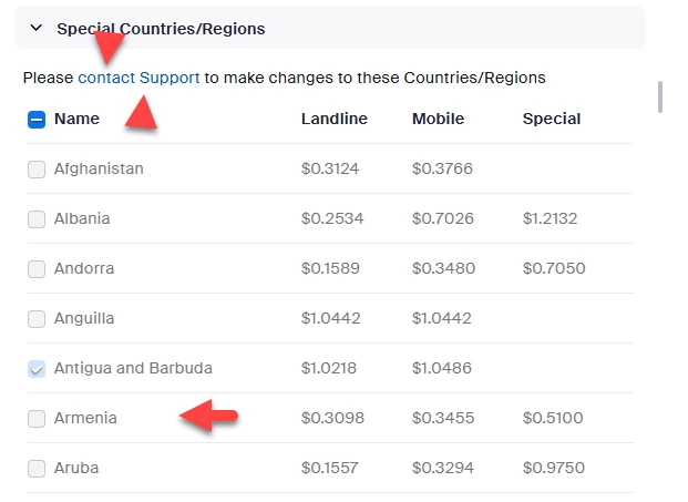

Armenia must be selected from the special countries/regions located in billing.

May 26, 2025 1:24 PM UTC
Thank you @Eliot & @sparrow
It worked for UAE & Turkey but not for Armenia.
It does not allow me to select Armenia. The check box is greyed out under special countries/region.

my mistake in not pointing out that you have to contact support to make changes to special countiries/regions.
