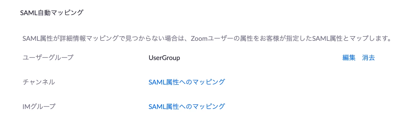

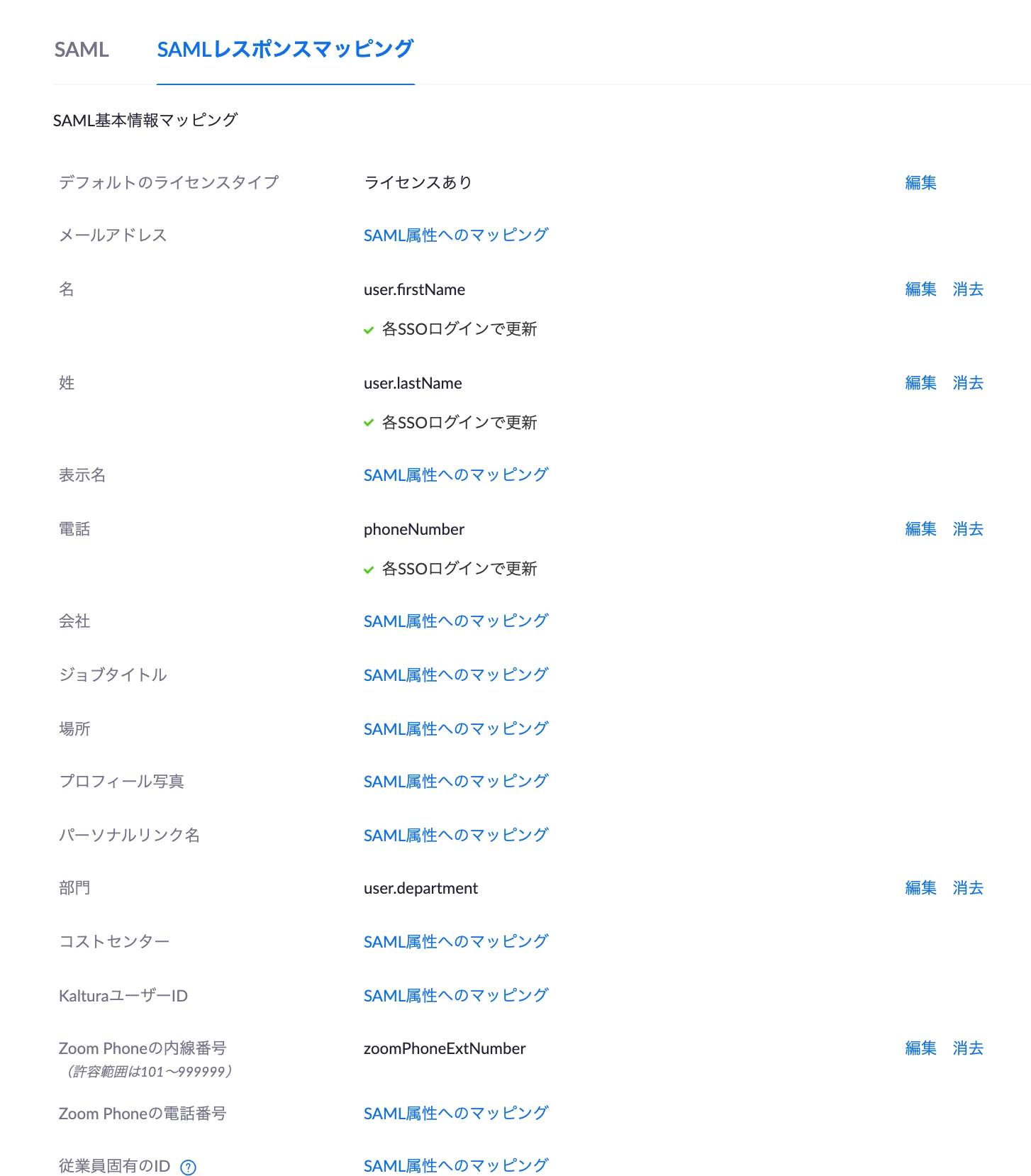

The SAML response mapping is configured as shown in the attached file zoom_samlResponseMapping1,2,3.

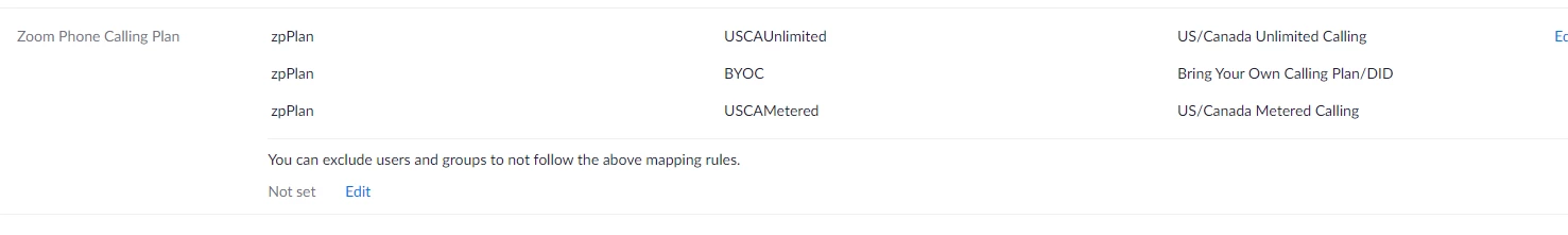

    Here is our test site setting for enabling a calling plan
    We assign USCAUnlimited, BYOC, or USCAMetered within okta under the zpPlan field.
    Do your users have the attribute 107 or 3000 assigned for the calling plan?
