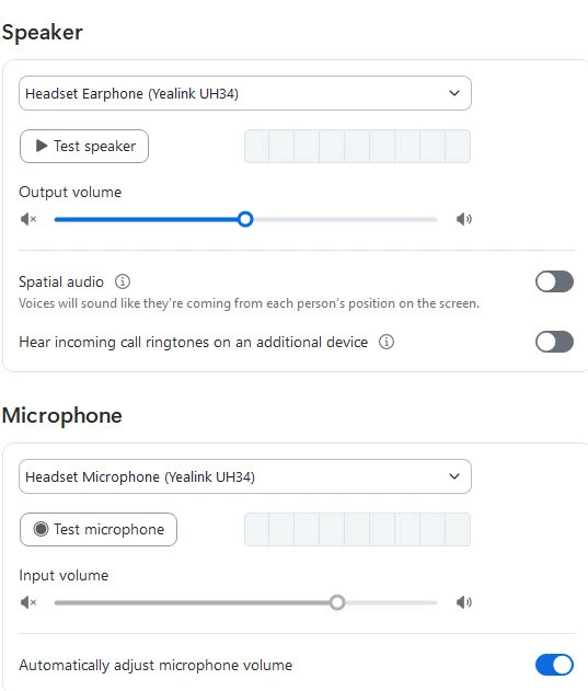

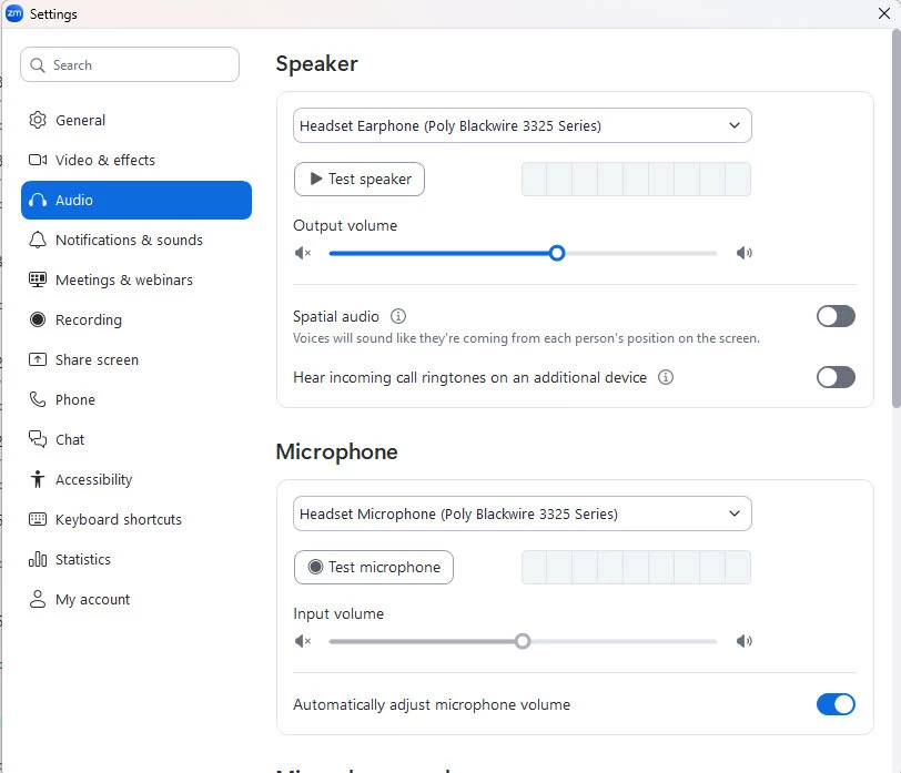

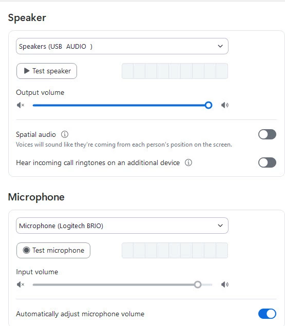

i have a poly edge e450 8.5.0.1492 and encounter the same issue with either yealink uh34 or poly blackwire 3315.  if i use pc usb speakers and logitech brio mic, no issues.

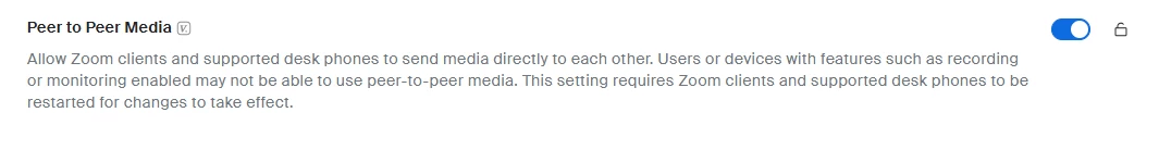

​@Eliot - do you have peer to peer media enabled for your organization?  Zoom support asked us to try turning that off.  Once we did that, our ability to switch without losing microphone audio returned.

thanks for letting me know.  i turned off peer to peer media and everything works.  screen shot before turning off peer to peer media.
thanks again.
