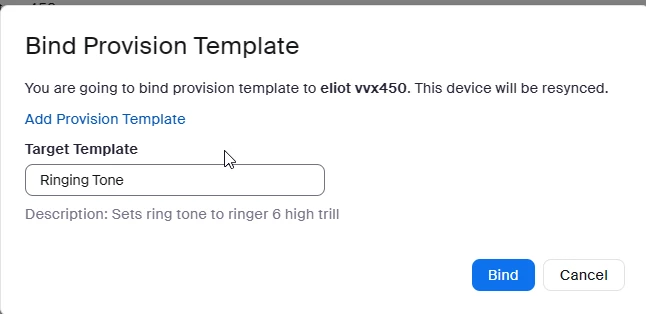

To set up a provision template, go to admin->phone system management->company information->account settings->desk phone->provision template.  Give the template a name and description and enter the configuration parameter.  Make sure you enter the configuration parameter exactly, observing upper case and lower case and quotation marks.  See example for Poly below.
Next, assign this provision template to whatever phones and devices that you want to use the template.

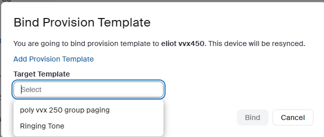

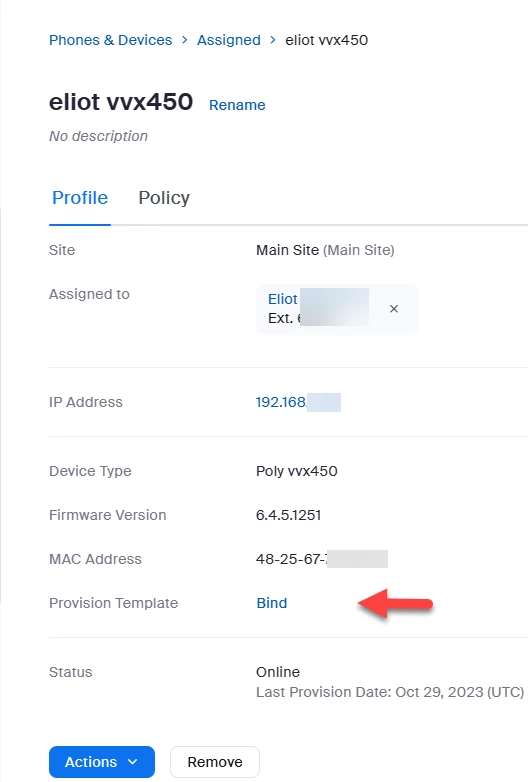

Go to admin->phone system management->phones & devices-> and select the phone you want to assign the template to and click provision template Bind.
From the popup, select the provision template to be assigned.
Then click Bind.

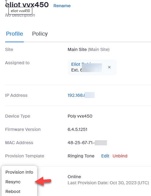

Finally, click Resync the desk phone to send the provisioning real time to the desk phone.
Your desk phone should have whatever ring tone you selected.  If for any reason, you experience an issue with assigning a provision template, (1) check details of configuration parameter and (2)  try factory reset on phone and then assign provision template.
