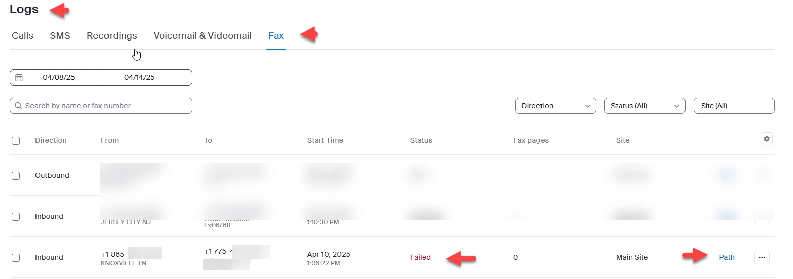

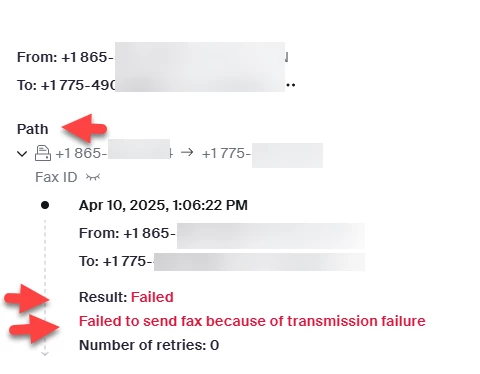

I believe that fax errors are detailed in the fax logs when you click “Path”.  This is what I saw on a received fax error.

Thank you for your response. There is nothing in my sent folder. When the fax fails, it goes to my drafts folder. The Path only appears for my received faxes. I am sending it to an actual fax machine.
