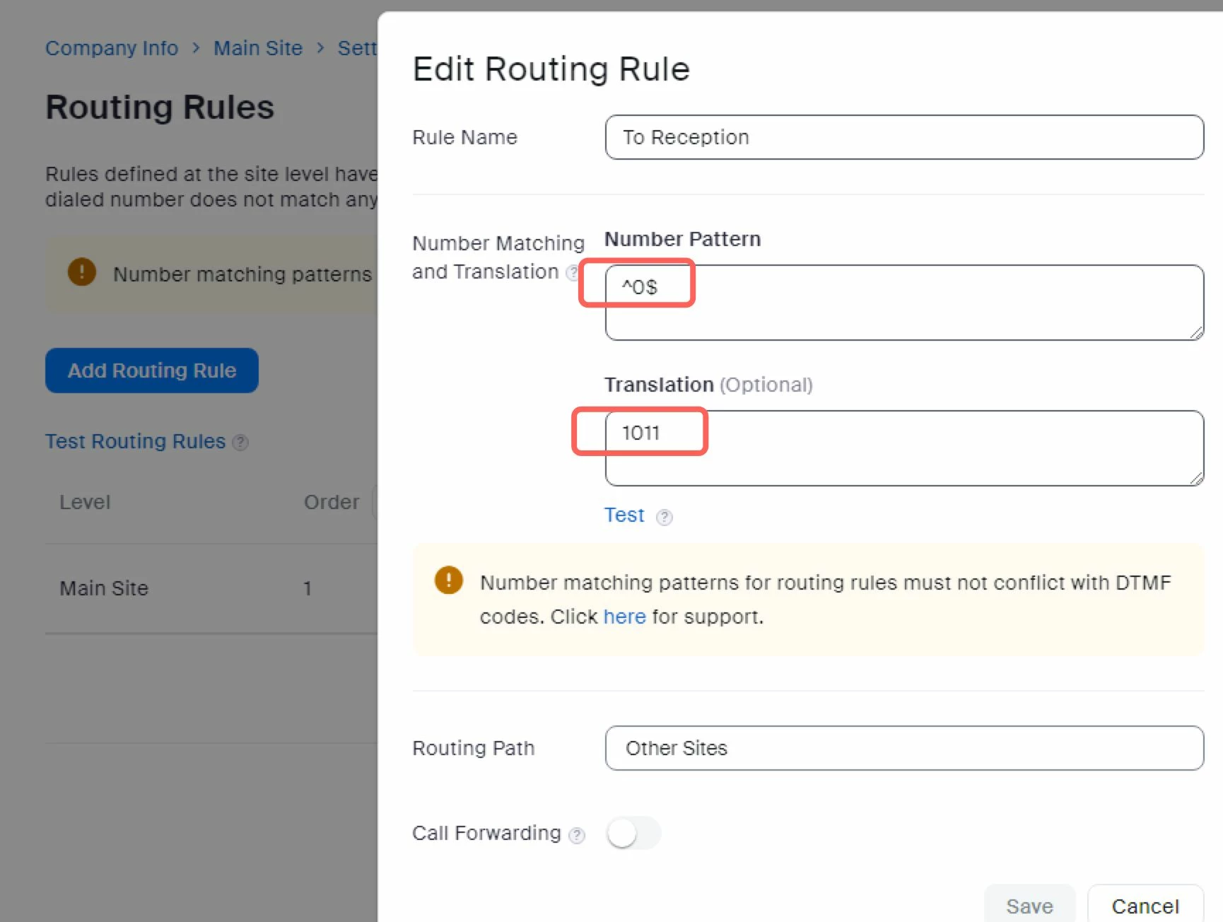

We are migrating off of a Cisco CUCM phone system going to Zoom Phone. Currently users on Cisco phones are able to dial "0" to get to the front desk operator. Is this possible with Zoom? I see that extensions have to be from 3 to 6 digits in length. Thank you!

    Can you try the "Routing rule" configuration likes below screenshot? Thanks.

    Thank you. This worked perfectly!
    January 17, 2025
    This solution is no longer valid for 2025 unfortunately
