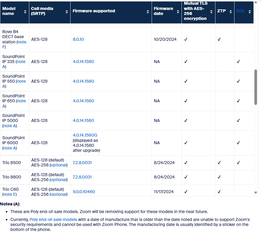

hi tartusa,
assuming your IP650 is poly soundpoint IP 650, it is supported for now.  please check that you have firmware 4.0.14.1580 installed. i did not see IP 550 listed.
depending on how your redundant internet paths are set up, you could have a situation where your connection is flapping between the two paths.  you could test this by temporarily disconnecting one internet connection.
