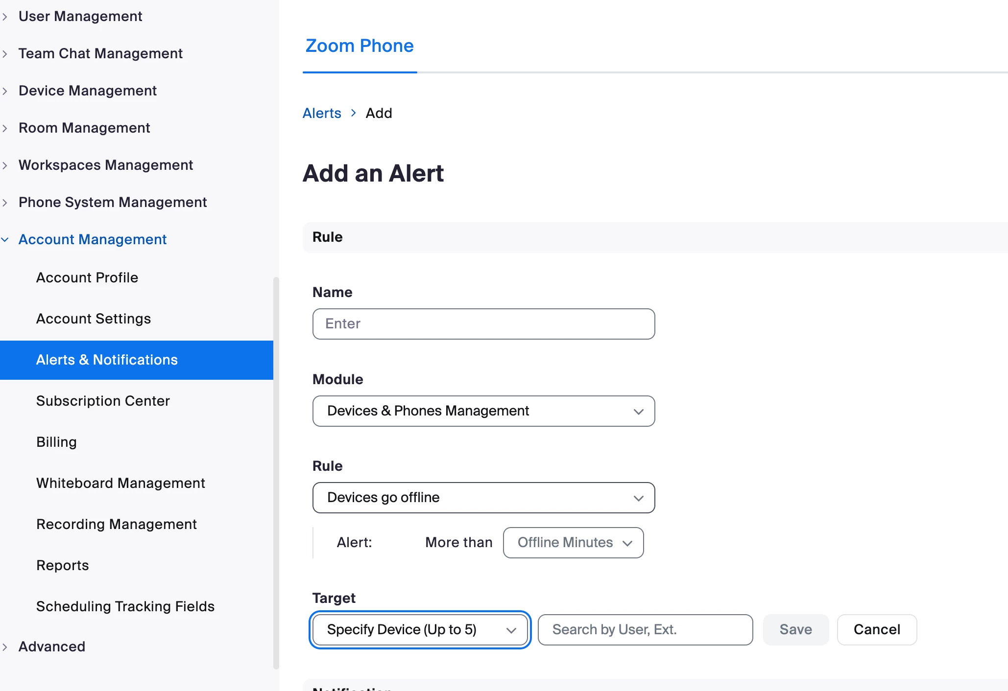

    Also, I recommend setting up an alert, so you can notified if a phone goes offline. See screenshot:
    If this response helps, please accept the answer as an accepted solution, so others can benefit as well.

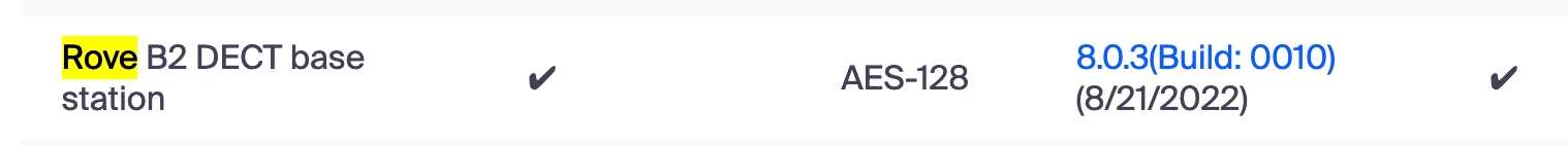

    Firmware is at 8.0.11 which is the latest level supported by Zoom.
    We have tried proactively rebooting the Poly B2 base unit at the start of everyday, but often the problem still occurs and another reboot is needed.
    Poly has firmware 8.0.12 available and this has a key fix that allows export of the SIP and SYSlogs for diagnostics.  But there is probably other stuff that needs to be supported by Zoom before I can upgrade.
    PS I have activated the Zoom alert as recommended by sachinzoom, but the minimum offline time you can select is 5 minutes.  My staff notice the drop usually during a call and reboot immediately, so I never get the alert notification.
