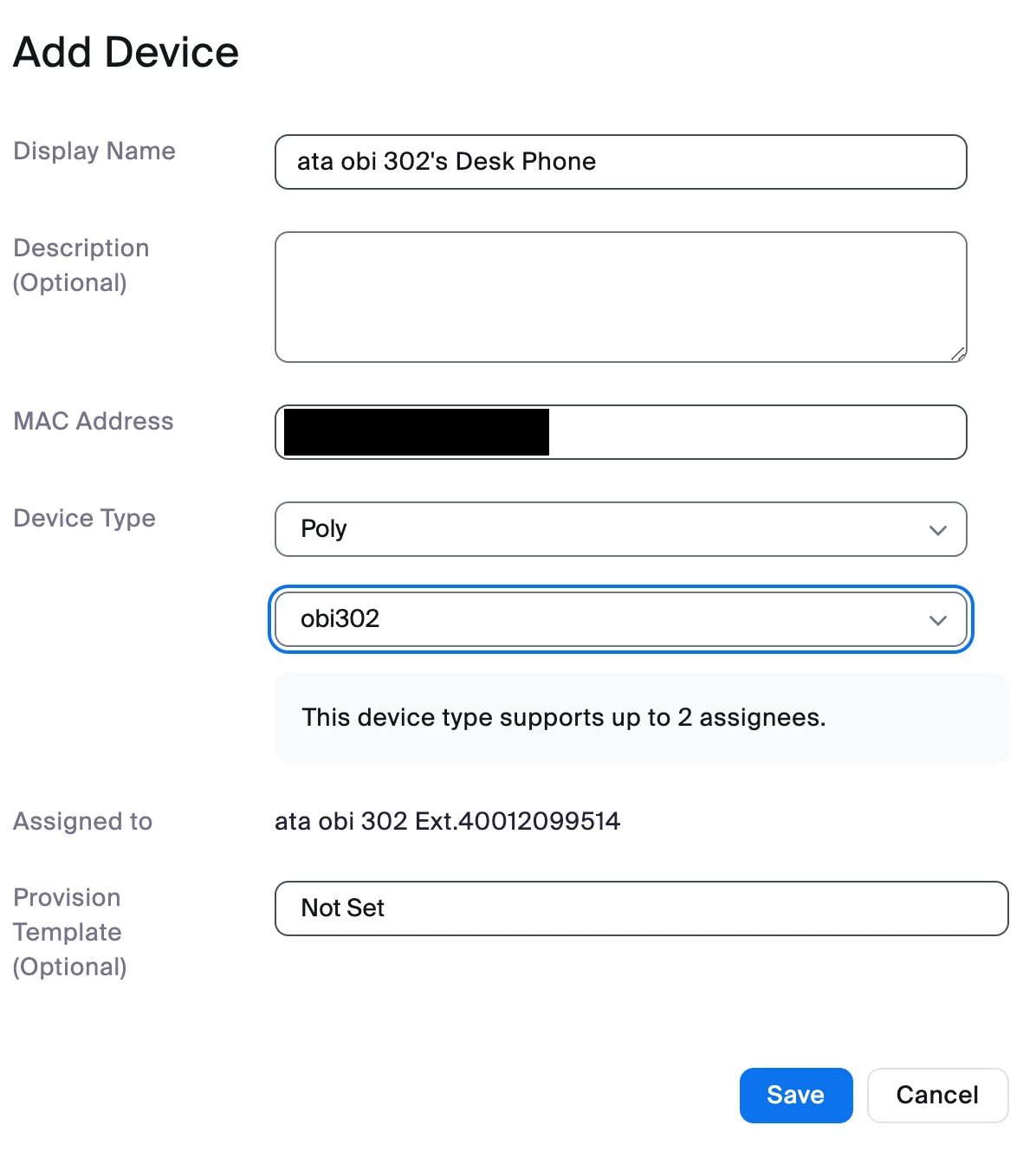

    You can create a common area first and then configure the two lines. See sample screenshots:
    Then under Settings -> desk phone, Click on the ATA:
    Make sure you assign it two extensions and then the two ports will be used. You can check under Ports and positions.
