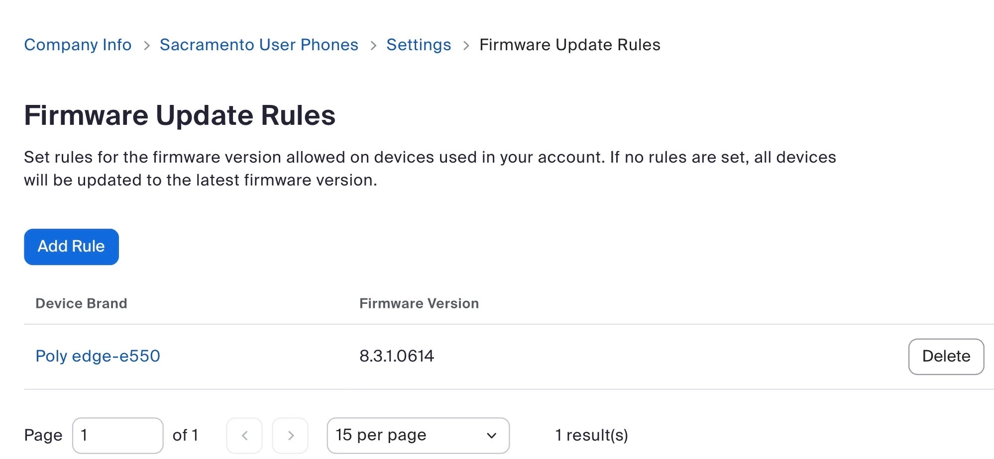

    ​@NorCal-IT we have seen issues with calls dropping, poor quality, line unregistered on our PolyEdge E100’s since the upgrade in Feb.  I have isolated to a different switch, different VLAN, etc.  How did you downgrade to 8.3.1?  In my device list I do not see that option?  It seems isolated to the desktop phones and not soft clients or zoom phone app.  I have opened a ticket with zoom and sent logs as well.  I am hoping for a new firmware update.
    Mar 23, 2026 4:19 PM UTC
    You need to create a firmware update rule at a site level and then you can explicitly pick the f/w version you want for each device type. You can also specify when you want it to roll out.
    Phone System Management → Company Info → (Select Site) → Settings → scroll down to Firmware Update Rules
    Mar 23, 2026 4:48 PM UTC
    Thank you sw916! I plan on rolling it back, so once I hit save, I can schedule the firmware rollback?  I am a little nervous about doing it during school hours and when I click save it starts the rollback.
