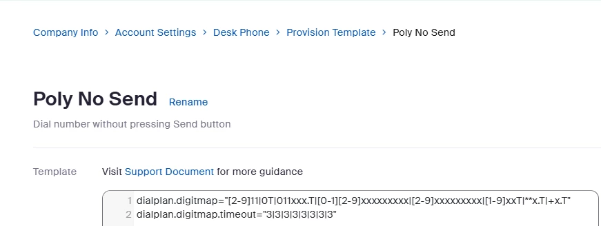

Add the following sample Dial Plan into a Provisioning Template , then the users will not be required to press the “Send” key to initiate a call on the Poly phones:
  • dialplan.digitmap="[2-9]11|0T|011xxx.T|[0-1][2-9]xxxxxxxxx|[2-9]xxxxxxxxx|[1-9]xxT|**x.T|+x.T"
  • dialplan.digitmap.timeout="3|3|3|3|3|3|3|3"

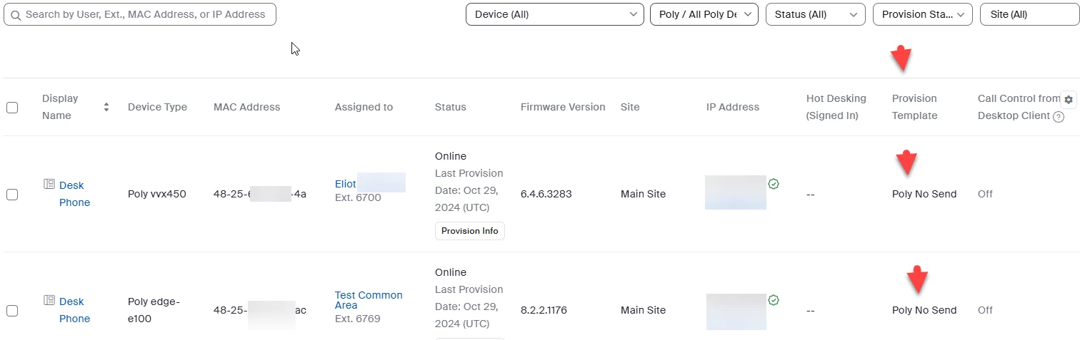

This is accomplished in the Admin Web Page, under Phone System Management , then Company Info > Account Settings > Desk Phone > Provision Template, see screen shot below:
 Once the Provisioning Template is created, you can Bind it to the Poly devices.

i suggest that you test this on one poly desk phone to be sure it works for you. in some cases, you will have to take into account the length of your extension numbers.  the sample dial plan handles three digit extensions, but this can be changed.
