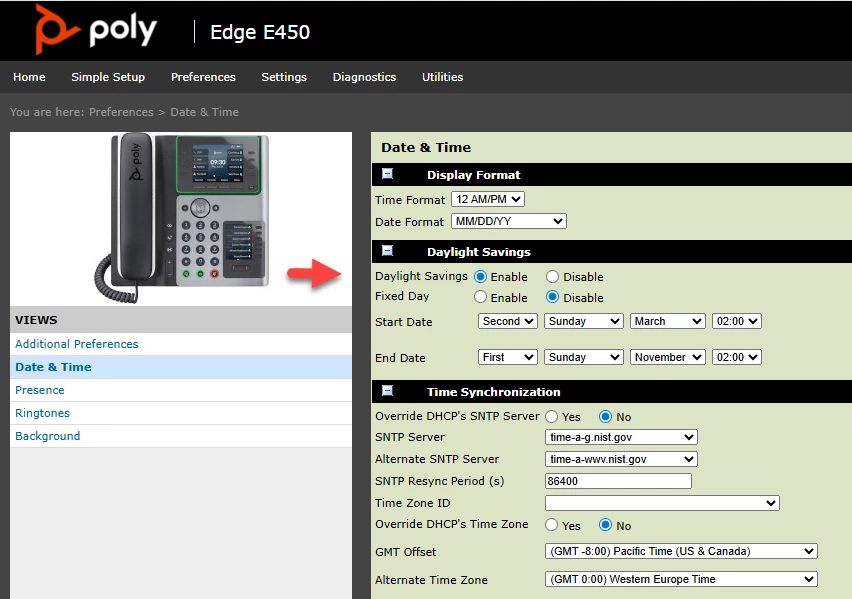

daylight savings time (DST) is implemented on the device such as a desk phone.  here’s what is see on my poly edge e series e450 after Zero Touch Provisioning (ZTP):
i would guess you should see something similar on your mitel phone.  I used Zero Touch Provisioning to set up my Cisco, Grandstream, Poly and Yealink phones and have never had this issue.
According to the Zoom support article, Zoom supports Zero Touch Provisioning (ZTP) for the Mitel 6900 series.  I would try resetting a Mitel desk phone to factory reset and then use ZTP.   I do not have a mitel phone to check.
