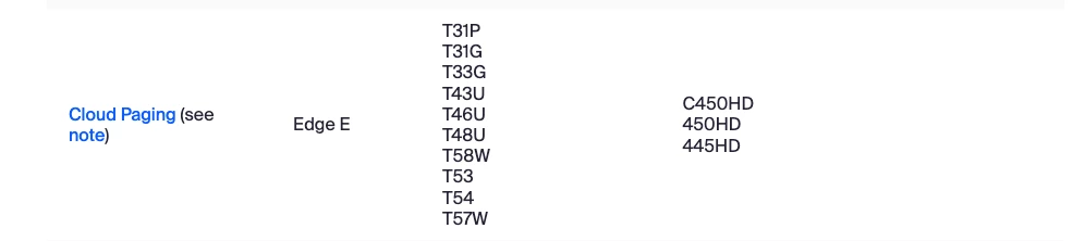

    There is a requirement to have a supported device attached to the users or Common Area Phone that are configured as receivers. It will not work if the receiver a Zoom Application only. For Poly desk phones only the "Edge E" series is in the supported list, that is why you need to pickup the handset to answer the "paging".
