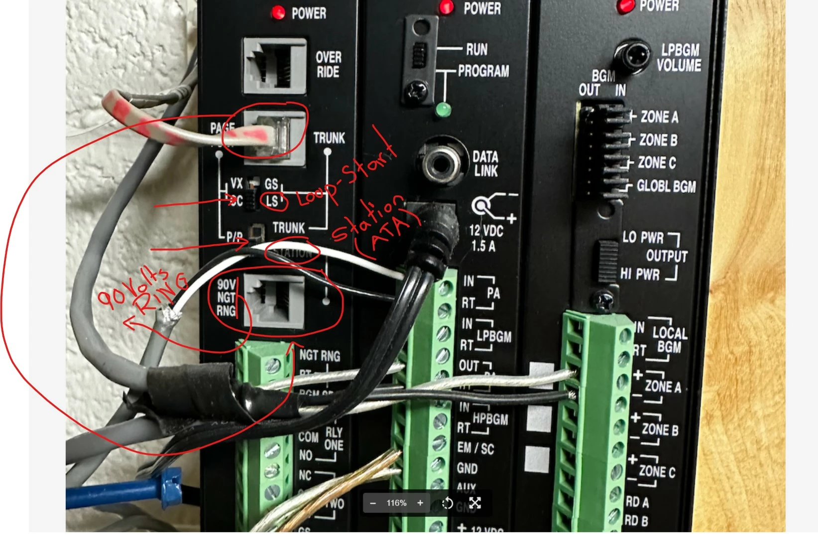

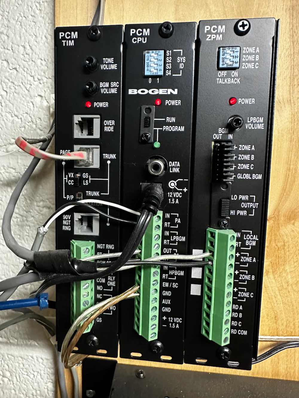

Thanks for such a fast and detailed reply. I'm the entire IT department at our school, so definitely more of a generalist that doesn't know as much about these things. The paging system does not have a model number but I've attached a photo. The closest thing on the Bogen website is a PCMSYS3. There is an RJ11-RJ11 cable going from the Trunk port on the Bogen to the FXS1 port on the Audiocodes. Good idea with the analog phone, I'm tracking one down tonight to try tomorrow. Thank you so much for your help! We have school starting next week and it's really a safety issue to not have the paging system up and running.

Now I was able to see the picture you sent (it helps a lot, thanks!).
I haven't checked the manual yet but I believe the RJ11 cable is connected in the wrong Spot based of what seems to be the settings:
  1. Up Switch seems to be setup to LS (Loop-Start) which is correct as your ATA only supports LS
  2. Bottom Switch  seems to be set to "STATION" (Which is what the ATA supposedly is giving you - FXS)
  3. The Red-Banded Grey-Cable ( I assume coming from the ATA) is connected to the "TRUNK" Port but I believe it should be connected to the "STATION" port, to match the current Switch Position configuration.
  4. I think the 90V NGT RNG says it send a 90 Volts Ringing signal from the Analog Line (ATA) to be detected as an incoming call/connection to be able to answer.
    I will take a look to the manual to confirm what I am saying; we don't want to damage anything, although those analog ports are very robust, it is unlikely they will "burn".
Vinnie
Vinnie
Aug 30, 2023 3:11 PM UTC
Hello Again @Scottdv
Look at the Page 12 of the manual, that should be your correct setup: PBX Station (FXS) Level, Loop Start.
I see in the picture, the cable is also connected to the TRUNK Port but if you read the description in the following Page 13, STEP 2 explicitly indicates to connect it to the RJ11 STATION/90V NGT RNG port which makes more sense for me.
I am convinced you should concentrate on page 12 and 13, and disregard the part in the diagram on which port the ATA should be connected to.

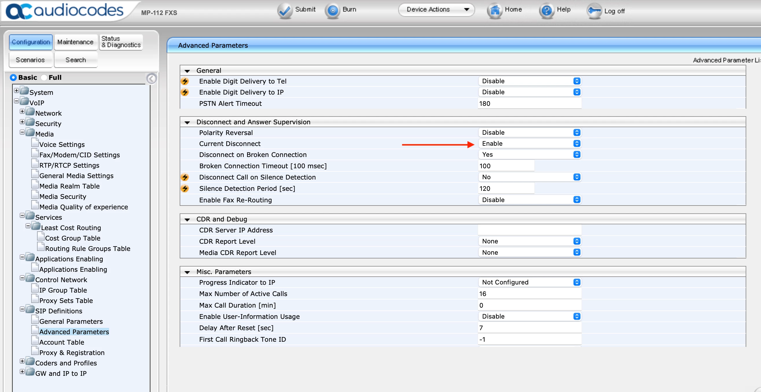

Aug 30, 2023 7:03 PM UTC
@Vinnie, I changed the disconnect settings in the ATA and everything is working as it should. For a school, a working overhead paging system is super important for safety, and I couldn't have got this up and running without your help. I can't thank you enough for all of your detailed explanations. If you're ever in the Philly area, I owe you a drink!

If you don't mind I will ask you for a favor so this post might be of any use for other people with similar requests: Would you explain what was the setting of the ATA that "put the cherry on top" and completed the solution?
Goo luck on Monday...school already started here last Monday. Having a lot of fun with the traffic 🙂
ScottdvAuthor
Sep 1, 2023 12:41 PM UTC
Absolutely, there was a setting on the ATA (Audiocodes M112) under SIP Definitions/AdvancedParameters/Disconnect and Answer Supervision. I enabled the option for Current Disconnect (screenshot attached). I used the tried and true method of clicking on every single menu option until I saw something that looked like it might be the right choice. That did the trick and I had it up and running about 30 minutes before our first safety drills of the school year. Thanks again and I hope this thread might help somebody with a similar problem in the future.
