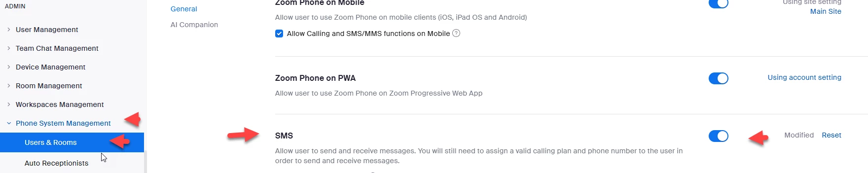

hi nsllc,
try enabling sms.  i am able to send sms from my t-mobile cell phone to my zoom phone.  i cannot send sms or reply because i have not set 10dlc.
thanks,  eliot
NSLLCAuthor
Nov 20, 2024 8:28 AM UTC
SMS is enabled for my user under the policy tab. I can also confirm the number in question is associated with the user. I also checked "Allow International SMS" in the box below the activate radio button in your SS.
NSLLCAuthorAnswer
