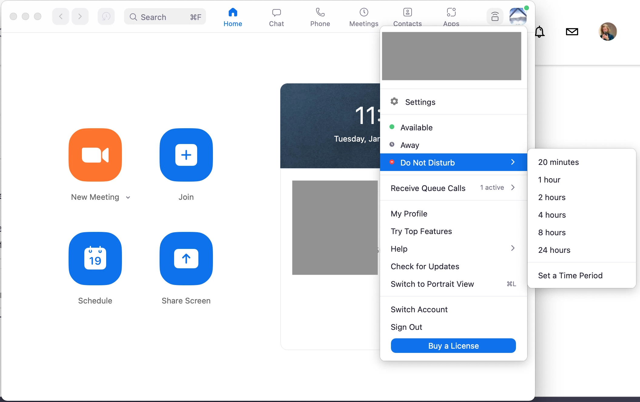

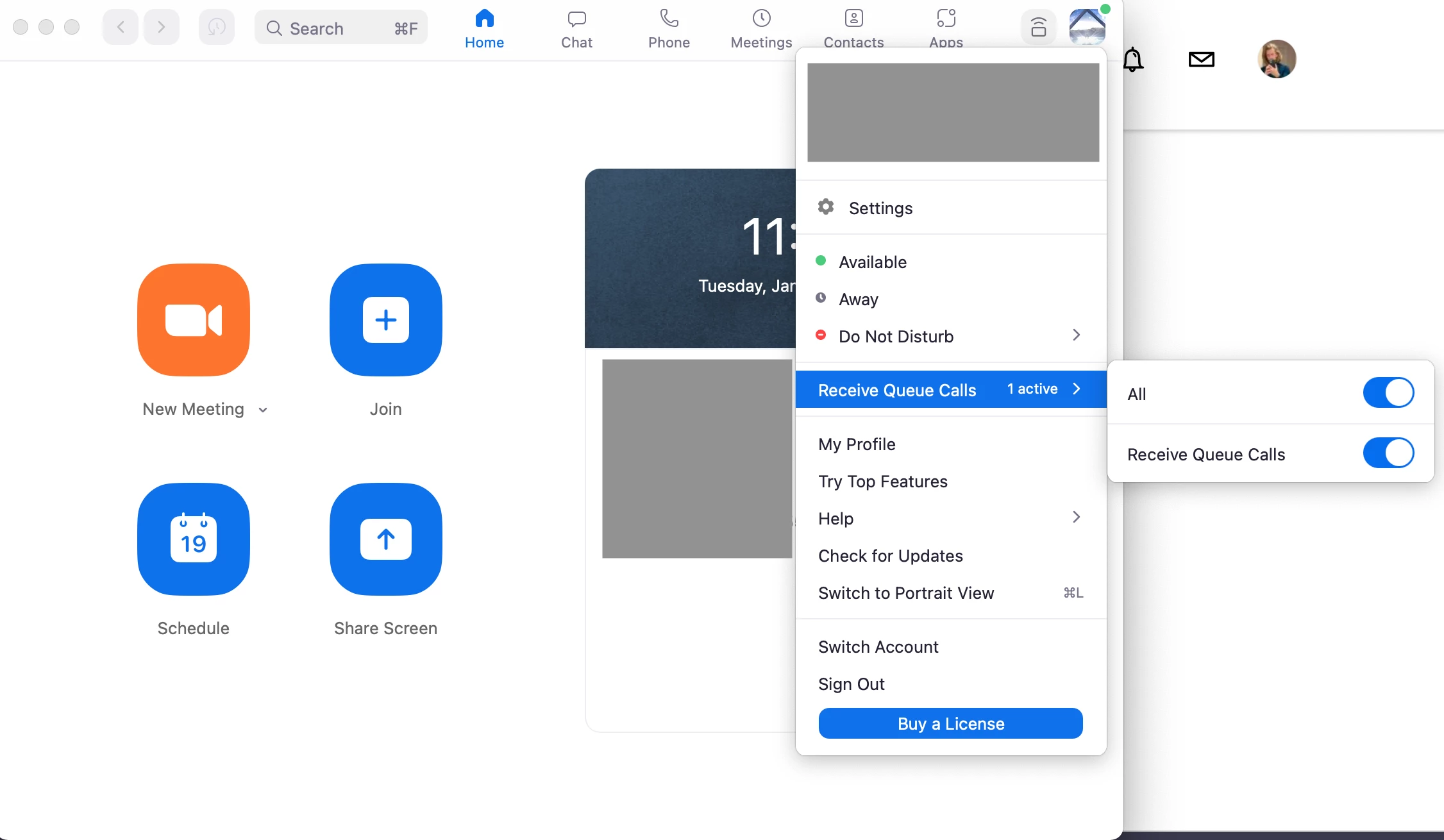

1) Use 1 Auto Receptionist that routes to a Call Queue with Business Hours of 8:30 to 5:30. All users who would answer the calls are part of said Call Queue. Users set themselves to Do Not Disturb, or switch off Receive Queue Calls, or simply quit the app (it they are using the desktop or mobile app) when they are not taking calls. See attachments.
