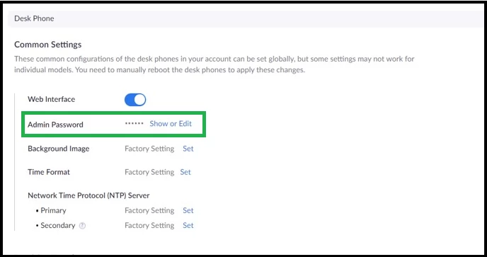

    The same thing was happening to us since we got the 8800.. See below fix/workaround we found -
    1. Using an administrator account log into Zoom's portal
    2. Navigate to Desk Phone Settings (Phone System Management -> Company Info -> Account Settings -> Desk Phone)
    3. Set a default "Admin Password" under the "Common Settings" section.
