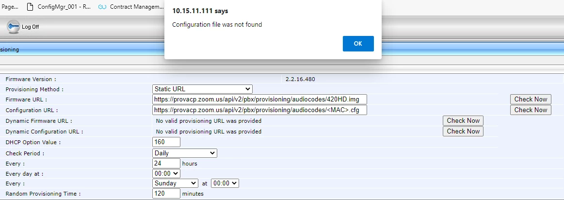

When provisioning as Zero Touch (factory reset), the device indicates that the Firmware URL and accompanying Configuration URLs do not exist (Configuration file was not found):
- Firmware URL: https://provacp.zoom.us/api/v2/pbx/provisioning/AudioCodes/420HD.img
- Configuration URL: https://provacp.zoom.us/api/v2/pbx/provisioning/AudioCodes/420hd/<MAC>.cfg <-- this is different than what the configuration site suggests (Zoom Phone provisioning drops the 420hd subdir, but we have tried it both ways)

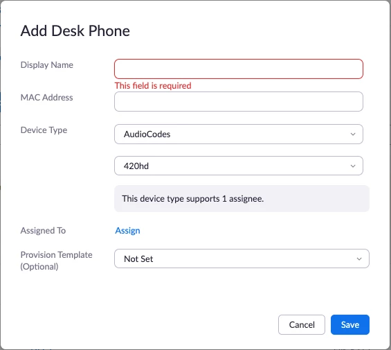

    Have you added the phone to Zoom Phone 1st?
    This should create the specific .cfg file for the mac address of the phone.

    The device was added first, prior to the factory reset.  It simply appears as though the portal is not creating the CFG file or its in a different location (as mentioned, the Help file indicate one location and the Portal indicates a separate).

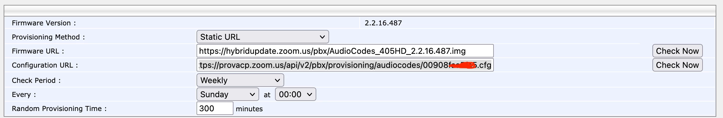

    @mof_cmsmith  - Configuration URL  in the MAC - please update with the phone MAC address. e.g.https://provacp.zoom.us/api/v2/pbx/provisioning/audiocodes/00908faa1245.cfg
    Note Attached sample screenshot for 405HD, but the process is the same.
    September 6, 2021
    Thank you for the assist on this.  When we first attempted to provision the phones, we did replace the <MAC> with the mac address.  Your statement validates our attempt.  It appears that either the CFG is not being created or the paths are incorrect per the documentation.
    Note:  your Firmware URL is different than the documentation, which was also an issue for us.  Once we changed the URL to mimic your screenshot, our devices pulled firmware properly.  It would appear that some inconsistencies in the URL paths exist.
