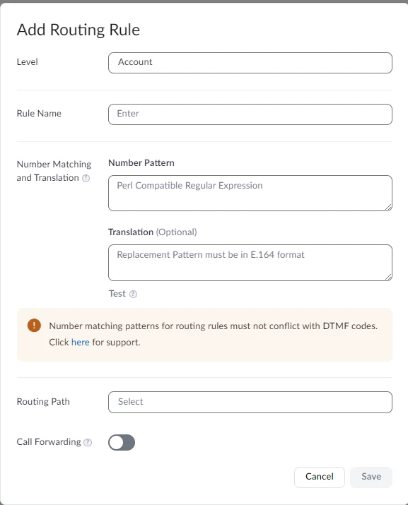

    Oct 18, 2022 2:15 PM UTC
    i have two poly vvx 250 and 1 poly vvx 411 on firmware 6.4.3.5156.  on the placed calls display and the missed calls display, they all have the +1 before the area code and telephone number.  calls to extensions only have the extension number.  i select the call i want to return and press dial to make a call.  everything works.
    if i try to manually dial the +1 telephone number using the vvx 250 dial pad, the call fails.  i also tried the windows client which also failed to connect using the +1 telephone number.  the windows client history does not include the +1  on incoming calls.
    the +1 is an international standard called e 164 which identifies a global ('+') number and an area including north america ('1').
    internally, telephone systems are programmed to route calls based on what telephone numbers are dialled.  for example, zoom phone knows how to route calls to emergency services, extensions, local telephone numbers in the same area code, telephone numbers in different area code, telephone numbers in different country.   this is called a dialplan.
    there is a way for admins to change their zoom dialplan, but any changes should be coordinated with zoom support.  please see company info->account settings->routing rules.  attached are screen shots.
    as to why two sites have the +1 and the others do not, you might check to see if the poly vvx 250 are running the same version of the firmware and if any changes were made to zoom routing rules and or poly dialplan.
