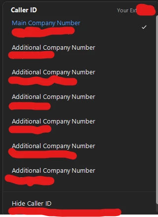

It is important for our businesses not to be conflated with one another. We avoid this by a). having different telephone numbers, and b). having different auto receptionists with different greetings, voicemails, etc. (e.g. "Hello, thank you for calling Company A," etc.) However, another thing we need is to allow our users, who may work for both companies, to be able to change their outbound caller IDs to either company, respectively.
I've enabled our users to be able to change their outbound caller IDs. However, whenever they switch their outbound caller ID (see attached photo) they get "Additional Company Number, Additional Company Number, Additional Company Number, etc." This would be fine, if when they selected one of these numbers, their outbound caller ID would reflect the auto receptionist these numbers are assigned to, but they do not. Instead, their outbound caller ID is usually our parent company, which, in turn, is assigned to our main site, which is, in turn, not the business they should be IDed under.
I've had a lengthy discussion with Zoom support on this. They told me that caller ID is generated at the site level. Create different sites, and then assign users under the sites depending on what outbound caller ID they need.
This could work for me, but at Zoom's current version (5.14.5), users can't be a member of more than one site. I could create multiple users for employees that work for different companies, but this is not tenable because users need to remain available to take calls for either business at any time. And they can only be signed into one Zoom user at a time.
In light of this, Zoom support has told me that my needs cannot be met by their system.
I understand that new legislation makes it harder for systems to account for multipler caller IDs due to fraud, etc. I also understand that is reliant on the phone carrier to display correctly (i.e. the caller id might show as a 9 digit direct dial number as opposed to the name of the site). Having a 9 digit number is fine by me, it just can't show as our site name, which doesn't apply to all the businesses we run out of our site.
Does anyone have any solutions?

Hello @Zoom_6
Welcome to zoom community and you are right about your assessment. Currently, Outbound caller ids, users mapped to one site behave as you mentioned.
I have configured such a setup for customers in the past and yes they do see Additional Company numbers. It is a feature request which will be available in future but not committed yet.
If you would like to share your company name, I can add you as an interested customer.
Hope that helps
