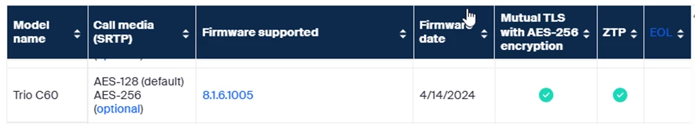

hi boyan,
do your c60 have the current firmware?
Zoom Phone Certified Hardware
thanks, eliot
