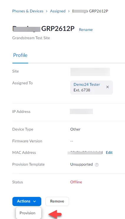

    goto phones and devices, add device type grandstream, model grp2604 and assign to a user.  goto assigned and select the grp2604p.  at the bottom of the screen, click Actions and Provision. you will see sip user id and authentication.  please see attached screen shots.
    i was able to provision a grandstream grp 261x using phone web interface.
    current f/w for grp 2604p is 1.0.3.67.

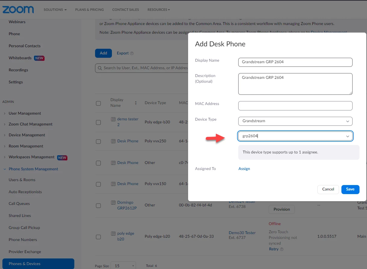

    Zoom has recently added Zero-Touch provisioning for some Grandstream desk phones including GRP 2604.  please see 8/10/2022 update of Getting-started-with-provisioning-desk-phones.  please also see a screen shot of screen to ADD Desk Phone.
    Getting started with provisioning desk phones – Zoom Support
