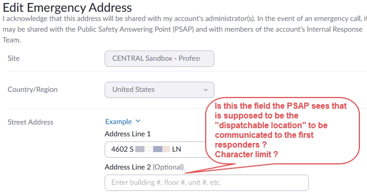

Q1 - Is there a length limitation for "Address Line 2" in the Emergency Address screen ?
Q2 - Which NENA standard for the PSAP Location element does ZP support ?

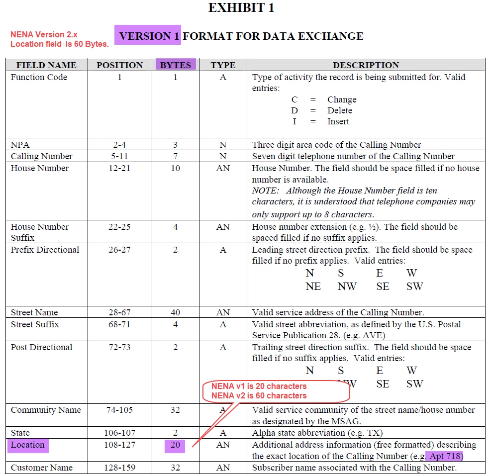

NENA v1 limited this field to 20 characters
NENA v2 increased this field to 60 characters.
Q3 - I want to verify in the Emergency Address screen the field "Address Line 2" is supposed to be the Dispatchable Location at the street address that is supposed to be communicated to first responders .
Is Address Line 2 displayed the PSAP operator as the NENA Location ?
NENA Data Exchange Format
See attached NENA doc, browse to v2.1 standards.

    This is an old thread but may be helpful for people searching in the future.  I was not able to find official documentation but testing it seems that its NENA V2 ( trying to save more than 60 gives you the error "Enter up to 60 characters" )
