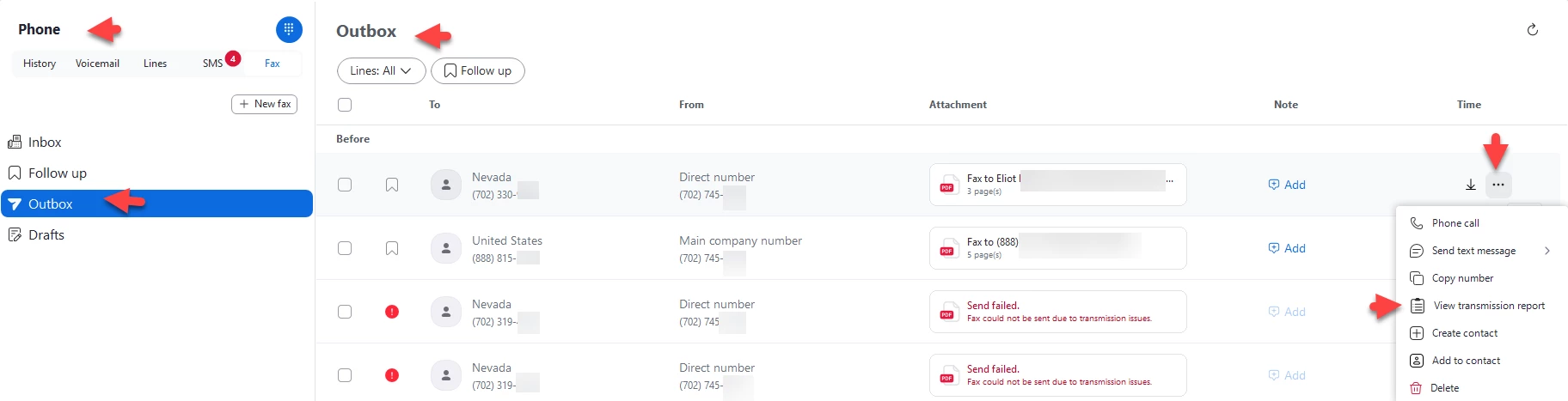

    The instructions in the link Sending feedback to Zoom say to click Help, then click Give Feedback (in the Windows desktop app). I do not have a Give Feedback option; under Help there is About Zoom Workplace, Zoom Support, Zoom Community, Report a problem. Version 6.7.5 (30439
    Feb 27, 2026 2:26 PM UTC
    Agreed. Would be helpful. I don’t even see an option for the transmission report. I’m trying to figure it out because there is no ‘view’ option where the documentation says it should be.
    zoom_timAuthor
    Feb 27, 2026 5:38 PM UTC
    in the workplace app, try right-clicking on a fax in the Outbox- the context menu should show an option for View transmission report. Alternatively, when I click on a fax in the Outbox, additional details are revealed and there is a View transmission report icon under Actions (my Zoom window needs to be maximized for Actions to show).

    Feb 28, 2026 12:02 AM UTC
    hi ​@zoom_tim ​@FunkiNATEr
    here is a screen shot showing view transmission report..
    Viewing the Online Fax transmission report
    thanks,  eliot

    Eliot
    Nov 9, 2026 11:55 AM UTC
    hi ​@JLo91101
    I do not think email notifications for failed faxes is available yet.  However, you can see status of all faxes including Failed Faxes.
    Enable outbound fax transmission reports
    A Zoom Phone administrator can:
    2. Navigate to Admin Center → Settings → Zoom Phone.
    3. Find Messaging & Fax → Online Fax.
    4. Enable Transmission report for outbound faxes.
    5. Save the setting.
    Fax Send Failures
     In the Zoom Workplace client, go to Zoom Phone, Fax tab, Outbox.  Failed faxes will be displayed with a red exclamation mark and Failed to send fax to …
