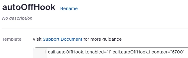

i do not know if the zoom desk phone template i used for one of my poly vvx desk phones would work for ata 400.  this works with vvx to auto dial extension 6700 when you pick up the handset:
https://support.zoom.com/hc/en/article?id=zm_kb&sysparm_article=KB0062241
thanks,  eliot
