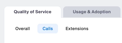

@justinmarthaler - While not the intent of the report, if you go into the Dashboard and click on the phone option at the top, choose the first tab (QoS), and then the second sub-tab (calls), you can sort by device type.  If anyone doesn't have a call for their IP Phone, it would indicate they are not using it (at least in the time period selected).
