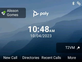

AGomesAuthor
October 6, 2023
Just letting you guys know. I was able to create the softkey to transfer to voicemail by creating an Enhanced Feature Key (EFK).
The steps for doing this:
Go to the phone’s IP address on browser, login as Administrator.
Utilities > Import & Export Configuration
At the “Export configuration area” you export All configuration.
Open the .CFG file on notepad and ADD the lines below. I added near the EFK features but I don’t think it needs to be there.
Also you can use the name as you wish.
                                efk.efklist.1.mname="T2VM"
                                efk.efklist.1.status="1"
                                efk.efklist.1.action.string="$Chold$vm_$P1N15$$Trefer$"
                                feature.enhancedFeatureKeys.enabled="1"
                                feature.EFKLineKey.enabled="1"
Then go to the LineKey category you want to have your EFK and chose from SpeedDial to "EFK" or "Any". I put on my number 8
lineKey.8.category="EFK"
Save the .cfg file and import on the same place you exported. The phone probably will rebot.
If you want to disable this option change the line feature.EFKLineKey.enabled="1" to “0”
Attached you can see you it will be.
