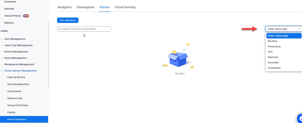

We've merged with another company, but are keeping the one phone number intact. I've recently ported the number to zoom and I want to create the ability to have our main number and the merged companies number with it's own extensions. I enabled multiple site and created a new site. When I try to assign the ported number the the new site, it doesn't allow me to accept the change (although it the new site shows it in the list). What am I missing or doing incorrectly here?

When I try to assign the ported number to the new site it doesn't do anything. I select the other site, but there's no step afterwards - see linked image.
Is this due to specific location requirements under the company (Like public IP etc). I did add this and I'm able to select a sub menu, but then I receive an error "Validation failed, detailed information is [Phone number has incorrect status.]." Is simply because the ported number hasn't been release? In the image you can see it's still pending (but the port is completed). It's scheduled for Feb. 1st, but I wanted to get a head start to make sure it's all set up.
thanks,
Peter

hi pheyblom,
because zoom seems to have the status of your port as pending, you are limited in what you can do until the port completes.
since there is a difference with your understanding of the port status and zoom status, i suggest that you
check with the porting team to confirm that the port has actually taken place.
based on you february 1, 2024 port date, your port should start on february 1, 2024 at 11:30 eastern time.  US and Canada ports start at 11:30 a.m. Eastern Time, Monday through Friday except holidays.

pheyblomAuthor
January 31, 2024
That was it. I tried the temp number and it worked. Just need to wait until the port takes place and swap numbers.

pheyblomAuthor
February 1, 2024
Port went through and all is working.
