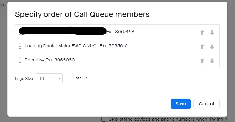

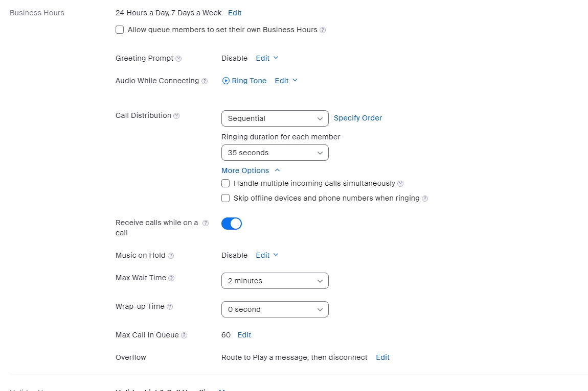

We are converting over to Zoom phone.  We have a call box at our loading dock.  I have an analog line from an ATA going to that device.  That extension has a phone number assigned to it also.  I have 3 members in a call queue that the call box dials.  The queue is set for sequential order. It is set to ring the following way:
  1. ext 100- receiving person's extension- User with unlimited package
  2. ext 200- Common area extension - unlimited package, set to not ring and fwd to an Auto Reception that in turn is set to call forward to a cell phone.
  3. ext 300- Common area extension - unlimited package, set to ring a poly desk phone for 15 sec then fwd to a call queue that will ring 2 other extensions, then fwd to an ext that is fwd to a cell phone.
When I press the button ext 100 rings for the set time (35 sec) then skips over ext 200 and rings ext 300.  I am not able to get the queue to ring ext 200 at all.  I can call ext 200 from a phone and it will ring.

When a call is routed from a call queue, it will ignore most of the member extension's call-handling settings. That being said if the call flow you are describing is the member extension's call flow - there is a high likelihood that most of the other settings are overridden by the Call Queue settings and resulting in the failures.

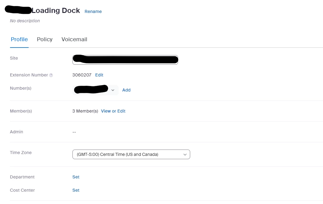

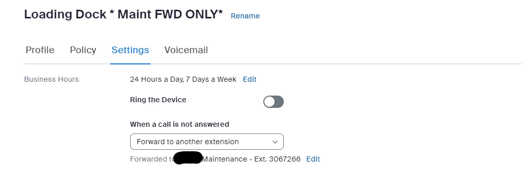

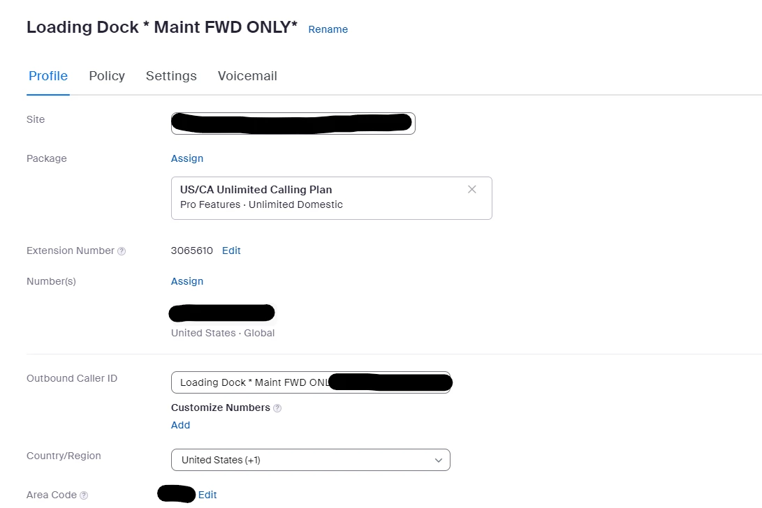

Thank you.  I have verified that my 2nd option in the call queue is a common area phone with a calling plan. that common area is set to forward to an auto reception that is call forward to a cell phone.  I have uploaded some images. Thanks

Here are a few more images
