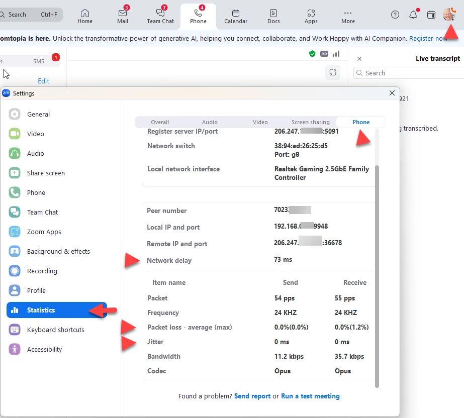

you can also see extensive stats while on a call:
thanks,  eliot
