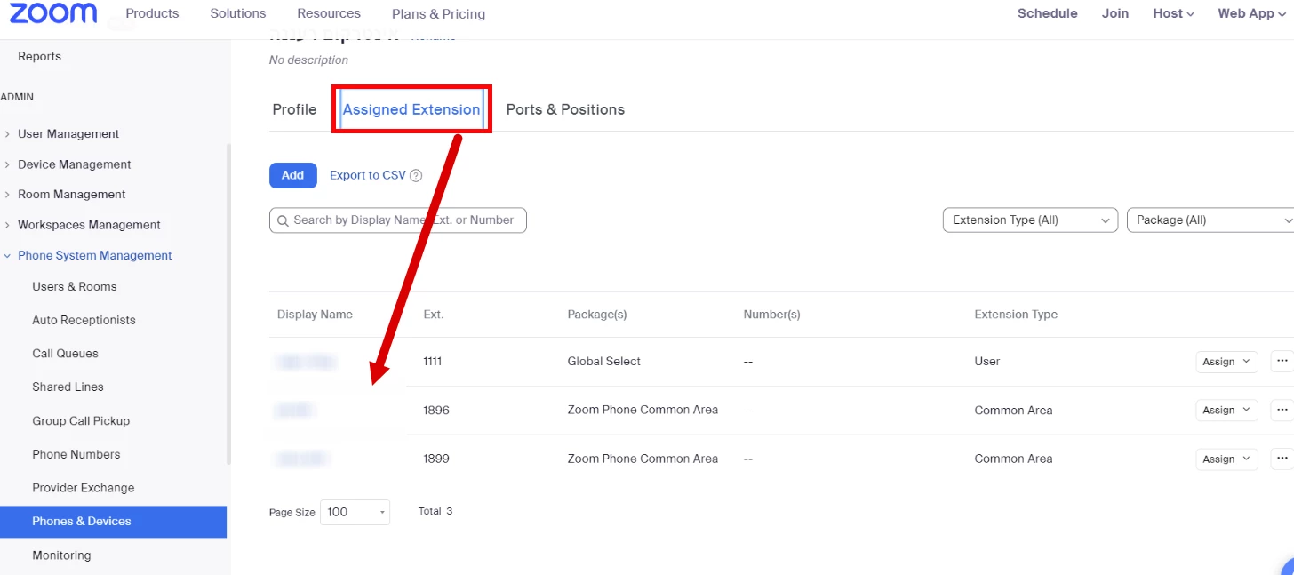

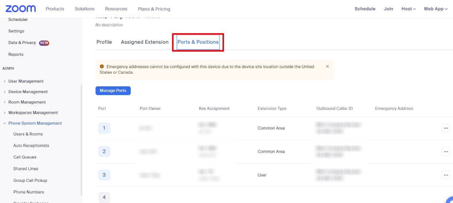

  1. Each port you use on the ATA should have its own extension assigned to it from Zoom.
    We can assign a user or a common area phone license.
    You can then decide which extension is assigned to which port (again from Zoom):

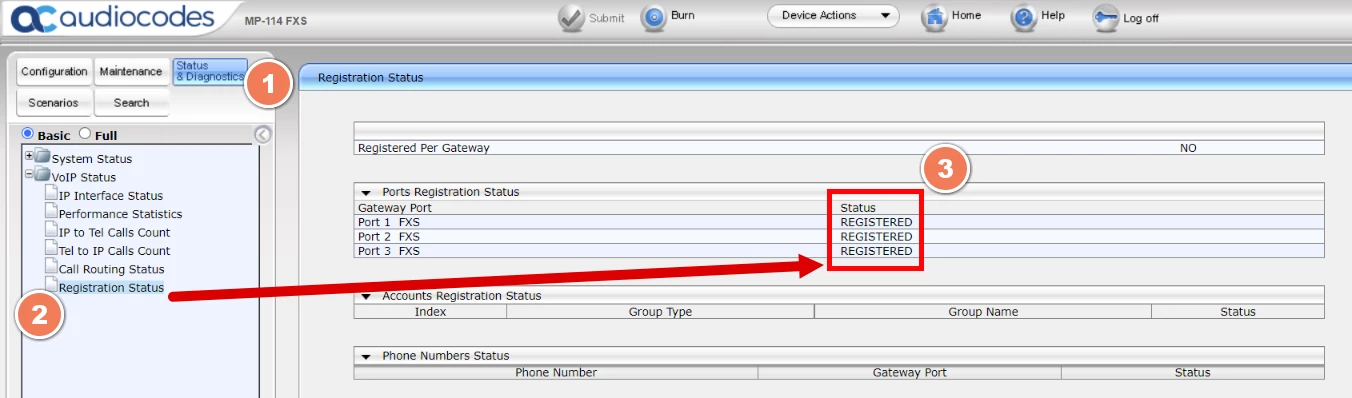

    Once assigned, we are basically done with all settings from Zoom's side. We now move to the ATA web interface. To confirm it's all working, you'll see the ports marked as "Registered" on the status page of the ATA, as shown below:
  2. Perhaps I missed it, but it doesn't seem that we can use the same extension more than once per ATA. If indeed possible, I would assume it would show as "Registered per Gateway" in the screenshot above.

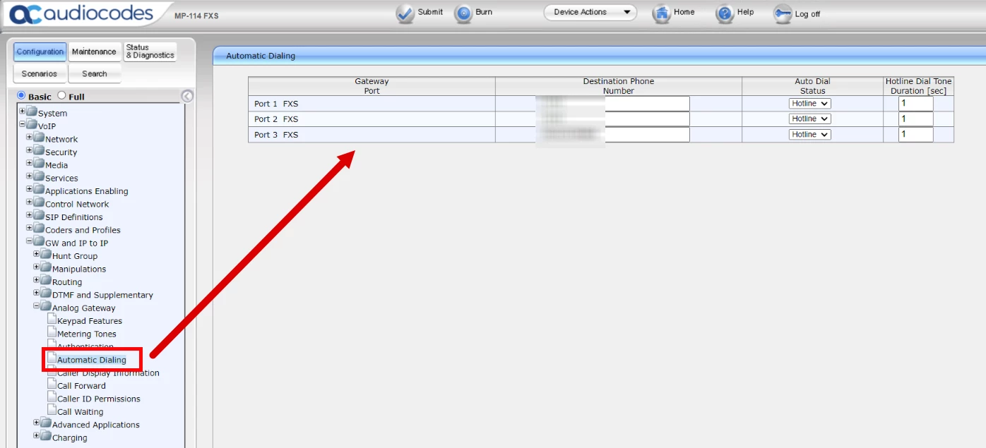

  3. For us, the best solution was to set up an auto-dial for each extension. This setup is done on the ATA's web interface and has nothing to do with Zoom. The ATA can dial either an extension or an external phone number. In some cases, we had to add a one-second delay before allowing the users to dial, or for the ATA to auto-dial. This might be related to the connection speed on each site. We also had to set the ports to "Hotline", as shown below:
