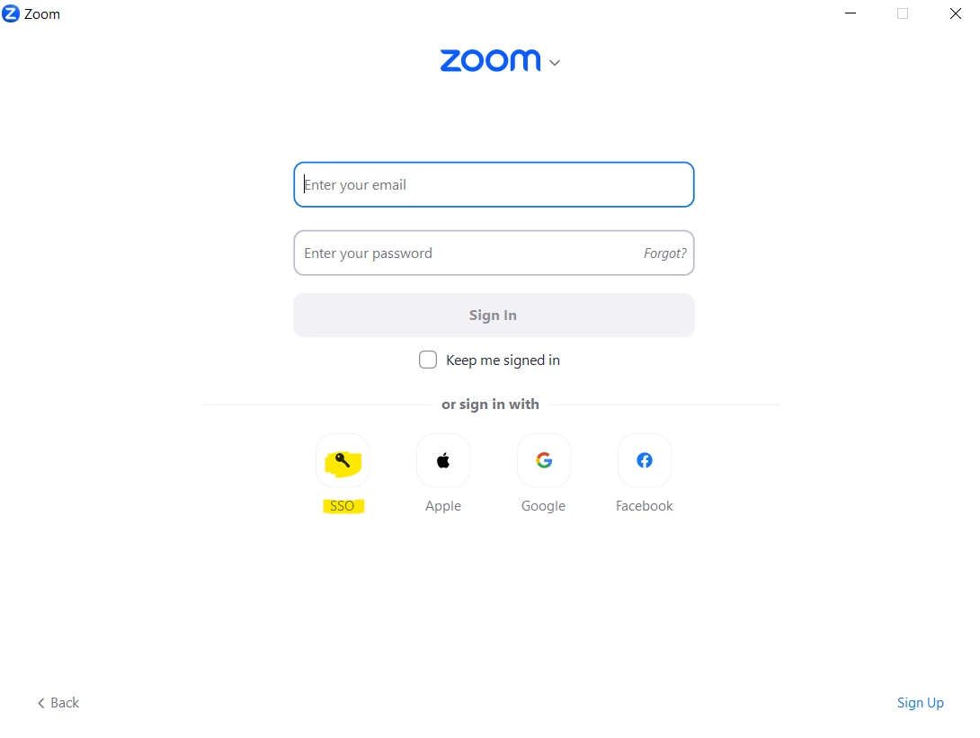

Do you use the SSO option to log into Zoom?
If your org doesn't use SSO for Zoom authentication, no action should be required. Other IT admins feel free to chime in here with additional info.
November 16, 2023
We do use SSO to login and it is still unclear what we have to update?

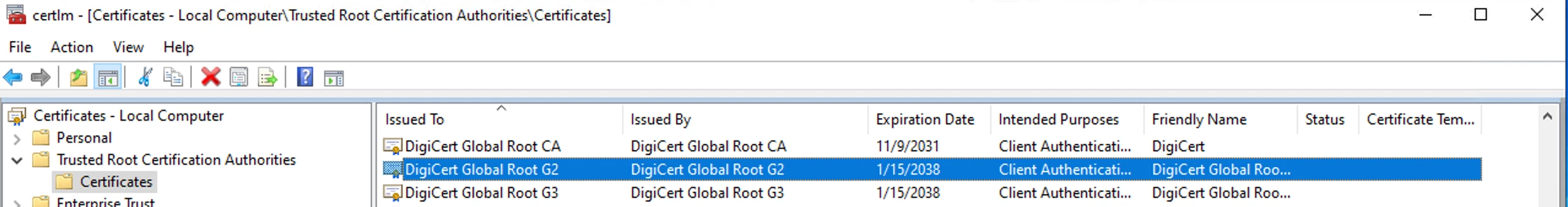

There are 2 components here -
1.) Endpoint certificates (most Windows/Mac machines with current a current OS will have the DigiCert Global Root G2 in trusted stores, but this can/should be checked just to be sure).
2.) The IdP you use for SSO
  "In addition, if you chose to disable the automatic update or if your IDP does not support automatic certificate rotation, action may be required for your account. More details to come."
I imagine that the overwhelming majority of orgs will not need to take any action if their SSO has been configured or looked at recently and if their fleet of endpoints is either relatively current or managed by a competent IT team.
Either way - very much agreed that the announcement was unclear and put a LOT of people into panic mode. Let's see what "more details to come" means with the deadline so close.
bstrelko
November 17, 2023

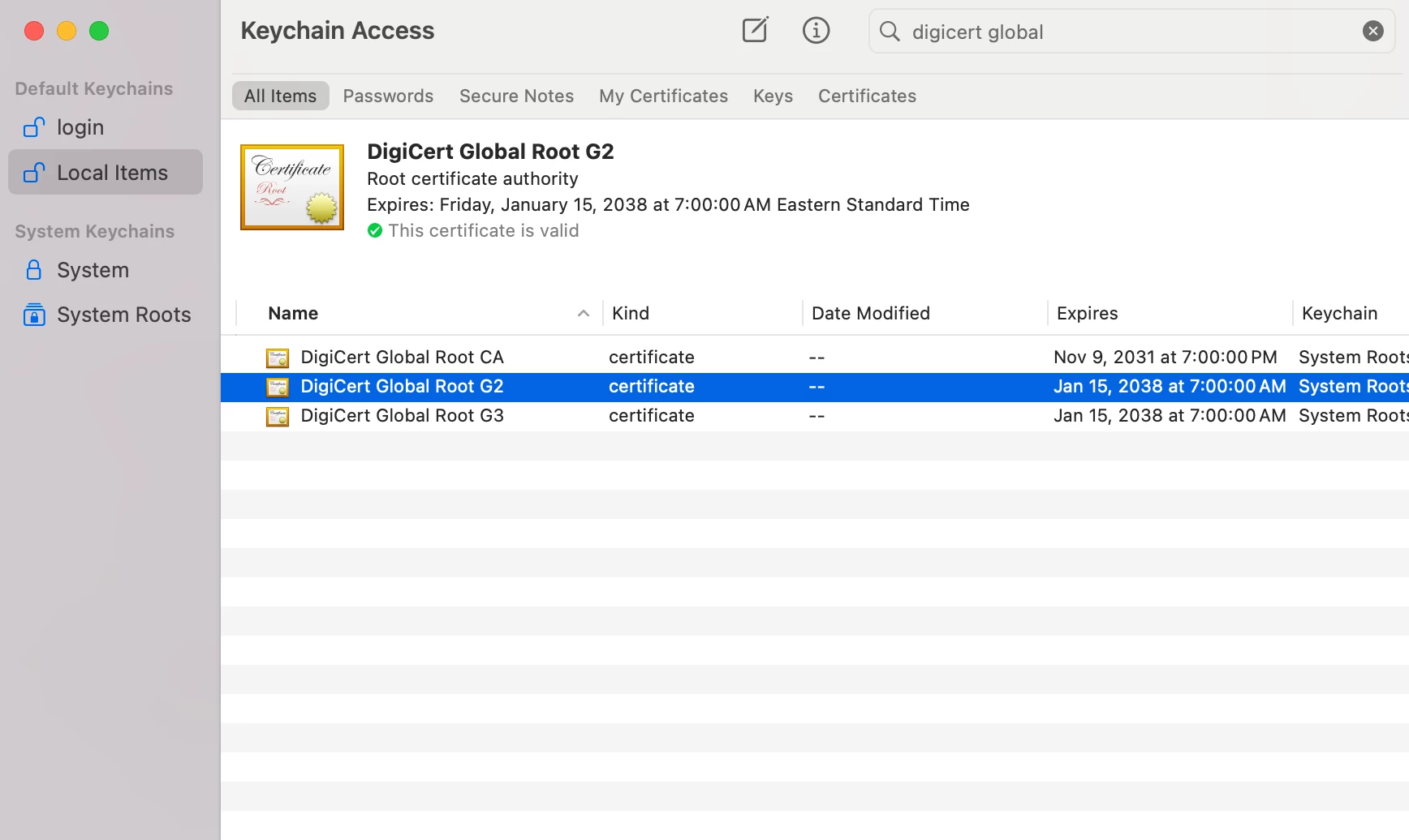

Regarding checking endpoints for DigiCert Global Root G2, you can use Keychain Access (built into MacOS):
Or Certificate Manger / MMC (built into Windows):
November 17, 2023
As others have posted our SSO is configured through Google Workspace and is working well.
As @bstrelko posted our endpoint machines (Mac laptops) do have the "DigiCert Global Root G2" that Expires: Friday, January 15, 2038.

November 20, 2023
Same here, checked couple machines and all of them already have G2 certificate with same fingerprint and expiration date in trusted root folder.
I'm wondering if anything needs to be done on Azure side....
