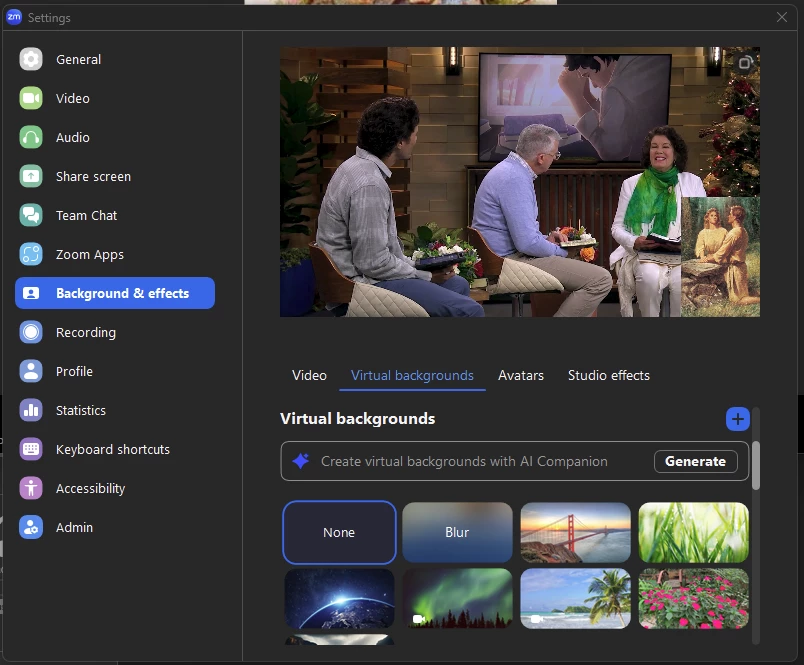

I use OBS to add logos to my video feed. Sometimes Zoom blurs out the logos on the bottom of my screen. It looks like it's trying to autofocus on my face or something.  Sometimes if I put my hand behind the logo int he composite video, the logo comes back into focus. I want zoom to just use my video feed exactly as it comes in, as I'm already modding it how I want in OBS.
This is coming from the OBS feed so I don't think it's happening on the camera (I'm using a newer iPhone linked to my macbook laptop over bluetooth).
Center stage is turned off, and there are no "blur" settings in Zoom -- everything seems to be off / default.
Any ideas?

Zoom does not distort the video unless blur is selected in "virtual backgrounds". Would need to see screenshots of the "virtual backgrounds" tab including the image of the webcam feed video. The shot should look similar to this one below, which is an example of OBS Studio input to Zoom with an overlay.
July 16, 2025
I know it's been a few months, but I was experiencing the same issue as you.  I finally discovered that it was the 'Portrait Lighting' option in the video settings that was doing it.
Not sure if that's what is happening to you, but turning that off worked for me.
