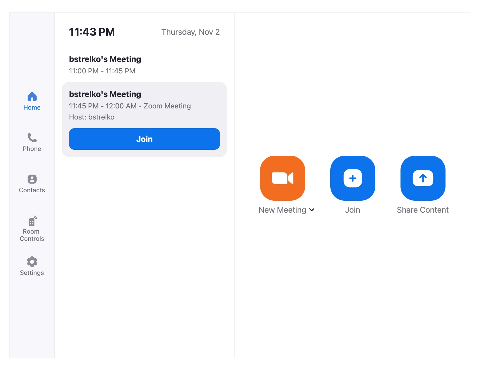

    Can you confirm there is a Zoom Meeting actually attached to the calendar appointment? If there is a calendar appointment without an attached Zoom (or even Teams/Meet) meeting, it will still show on the Zoom Rooms controller, but you won't be able to join.
    Calendar invite with no associated Zoom Meeting:
    Calendar invite with associated Zoom Meeting:
