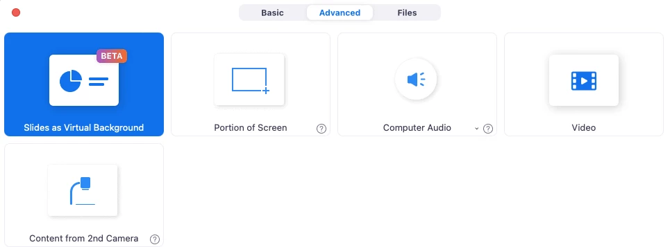

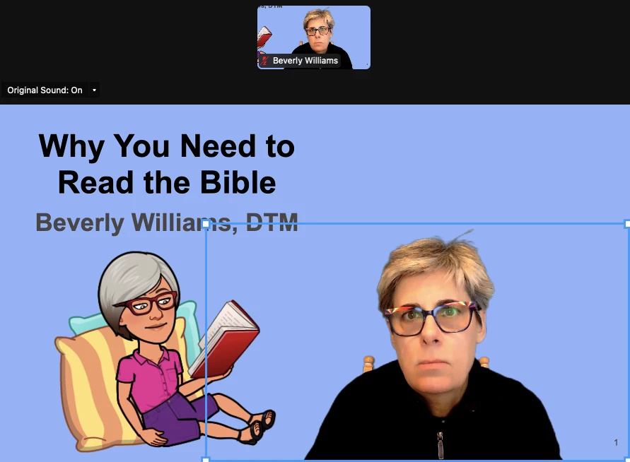

    2. In the advanced  sharing options, there is a beta "share slides as virtual background".  You load your pptx and play them as you would normally, but you appear ON THE SLIDE and you can RESIZE YOUR IMAGE to be as big as you like.  Disadvantage:  your image is not mirrored.  I make so many gestures, I can't do this because I can't point to anything without a lot of practice.  Because of this, I have never recorded it.
