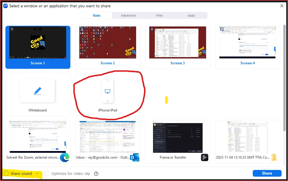

Consider the possibility of connecting to the meeting using the desktop Zoom app, but then use the Share Screen feature for iPhone/iPad:
Test it out... I don't recall whether that brings in audio or not... but I think if you select the Share Sound option (yellow highlight), it might work.  As long as your device is on the same wireless network as the PC, it should be fine.  I've tested using iPhone video before, but not audio.
Good luck!
