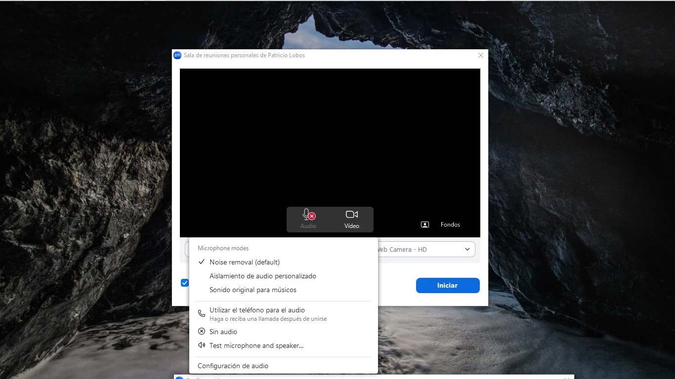

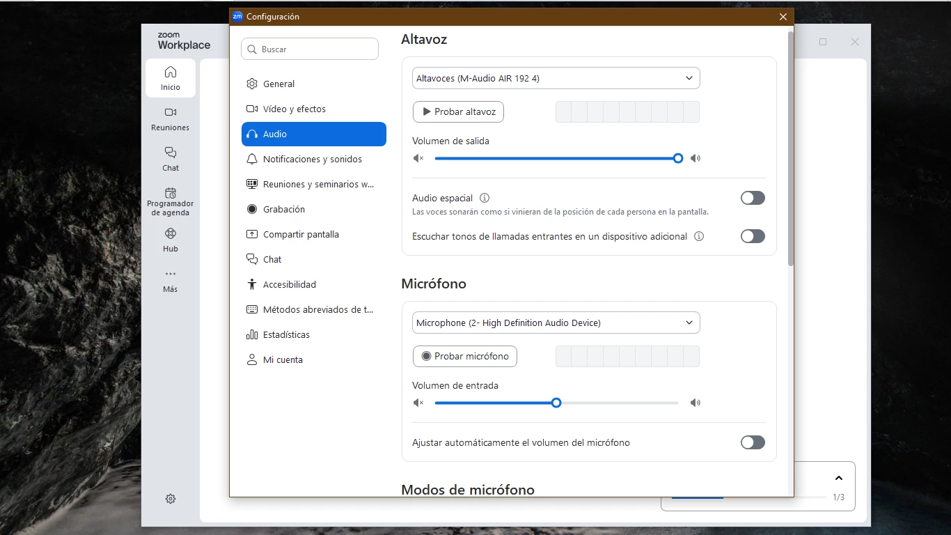

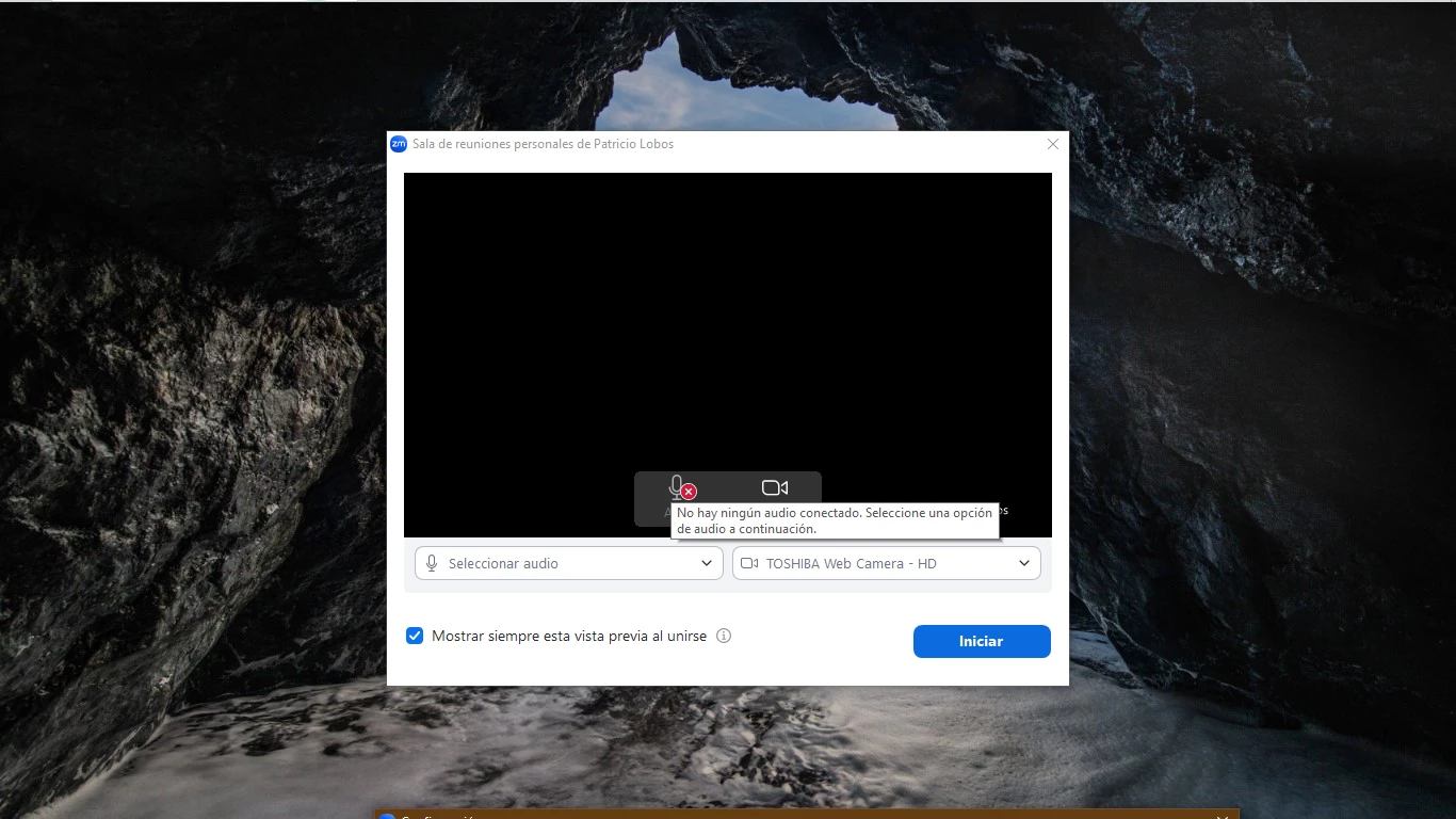

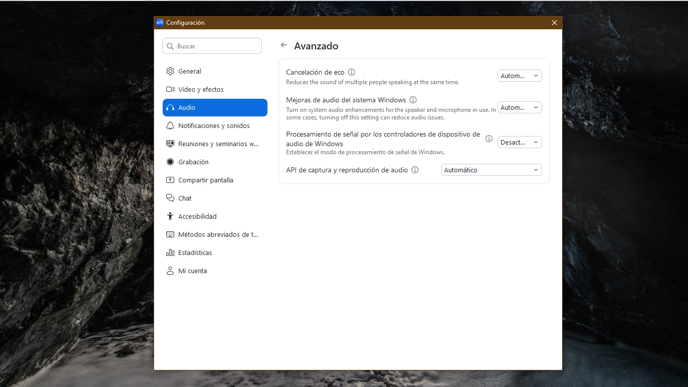

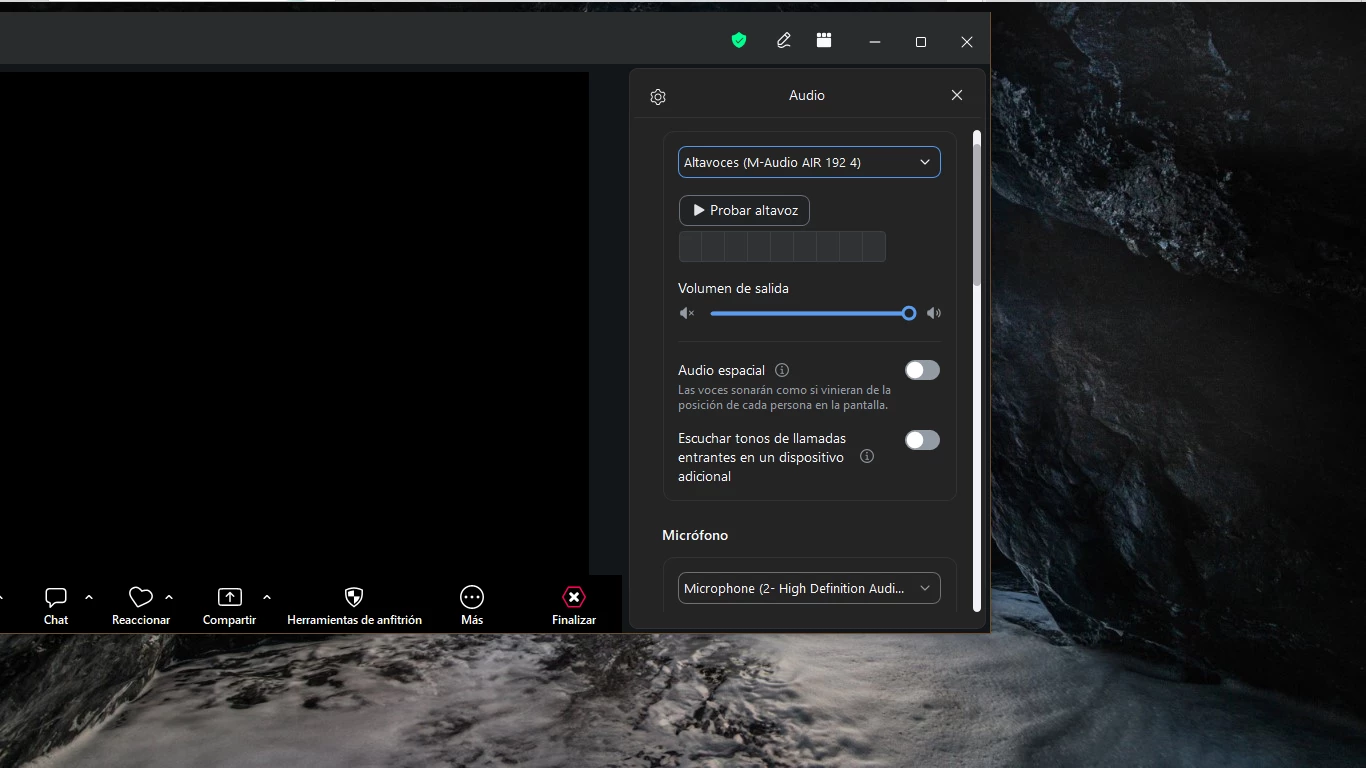

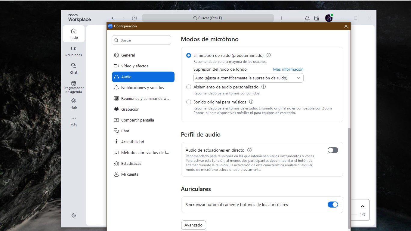

Hi! Thanks for the answer. I have already tried everything that you said before, but nothing seems to work. When I joined the test meeting, I was able to test my audio settings, but the meeting closed itself before I could click “Join audio”. When I try to host a meeting I still get the same error. I´ll send screenshots attached with this message of my settings and the error I see!
These are my zoom audio settings. I´ve trying to tweak them in different ways, following what I saw from troubleshooting blogs
This is the error I see whet trying to host a meeting. It won´t recognize any of the audio devices selected previously
As seen here, the are no sound devices from which to choose
If I enter the meeting I´m hosting without audio, and then try to set it up while inside, the devices I selected before appear still selected, but won´t appear in the list to use them, as shown before
