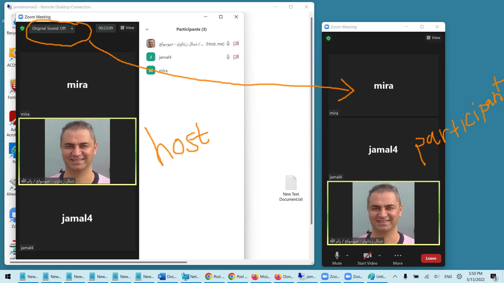

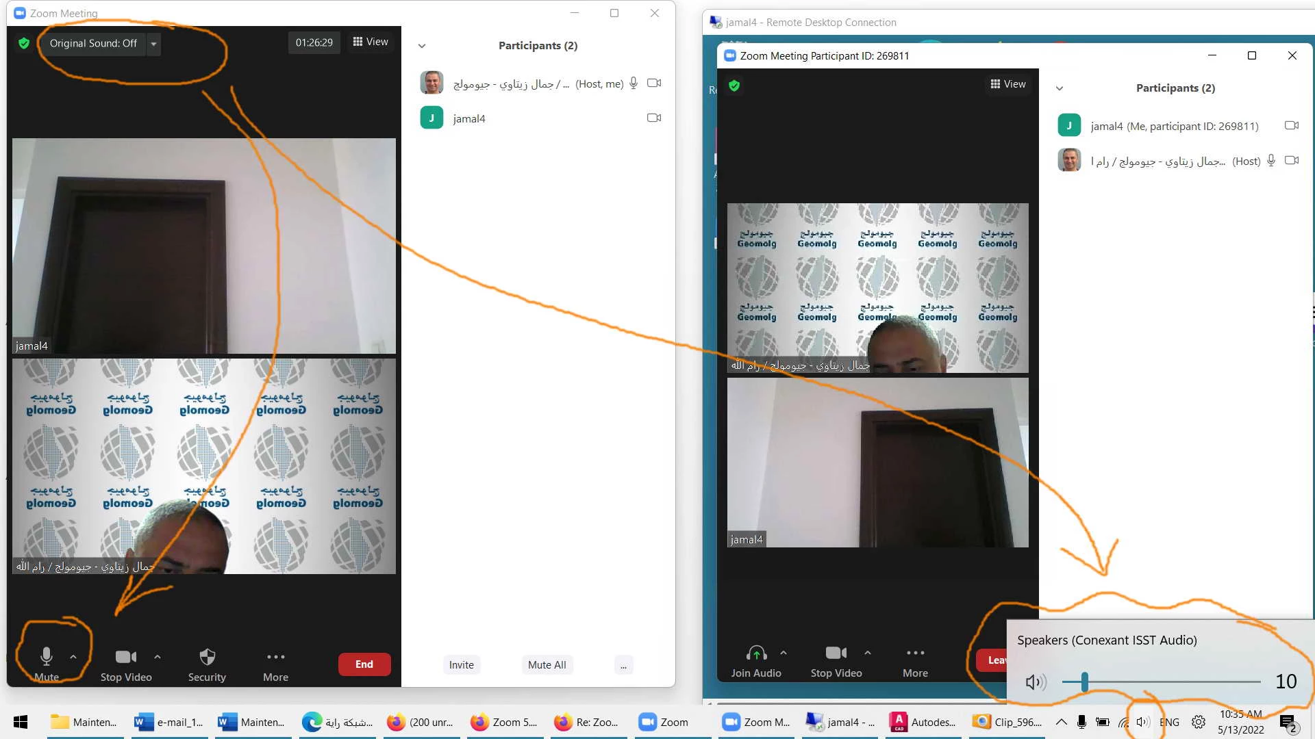

    jamalnuman
    May 13, 2022
    Why this option (original sound on\off) is not available for the participant and only available for the host?
    May 16, 2022
    The option would first need to be enabled by each user in their own Zoom client.
    jamalnuman
    May 16, 2022
    How it can be enabled at the Zoom client (screenshot below)? where is the option?
