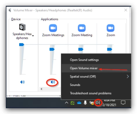

    I finally solved the problem with the help of the zoom support team!
    In my case, it was my computer's zoom volume mixer that was turned off for some reason.
    Here is the instructions from the zoom support team:
    Right-click on the Volume icon (on the task bar) > select “Open Volume Mixer” > form here, verify that all Zoom Applications listed are not muted.
    and see the attached photo from the zoom support team for further illustrations.
    Hope this helps you guys:)
    @minna1 @AngieB
    Sep 29, 2023 5:54 AM UTC
    The solution helped me solve the same problem. Thank you!
    Based on my observation in my case, I noticed that when I open a Zoom link in Edge, the Volume Mixer only shows one Zoom Application. Consequently, I couldn't unmute other Zoom Applications as suggested. However, when I opened the Zoom link in Chrome, the Volume Mixer displayed all Zoom Applications, with some being muted. Once I turned on the volume for all Zoom applications, the problem was successfully resolved!

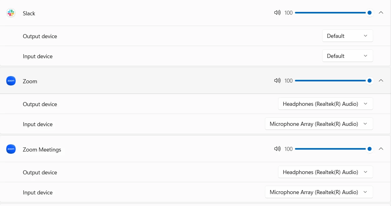

    The solution that worked for me:
    Settings > System > Advanced > Volume Mixer > Zoom
    Hit the drop down arrows and change the default input/outputs
    Don't leave them on default and manually select
