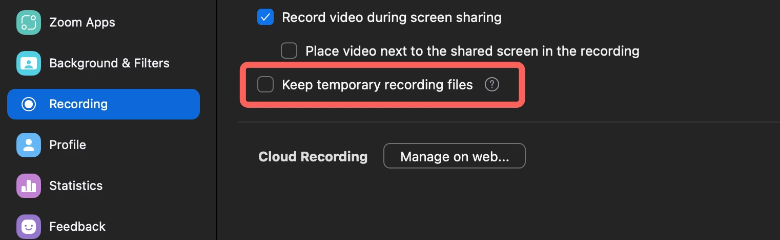

    Hi @MrsM99 !
    The usual reason you would want to keep those unconverted files would be for the purposes of troubleshooting if you were seeing issues with the conversion process, but otherwise you can set them to automatically delete as your friend has mentioned.
    In the Zoom client settings for the device where the recordings are saving, go to the Recording tab, and unselect the option for "Keep temporary recording files." With this option unselected those files will automatically remove after the meeting recording has been converted.

    MrsM99Author
    August 25, 2021
    Thanks so much! This is exactly it! I think I just couldn't see the wood for the trees in all the places settings are found. 🙂
