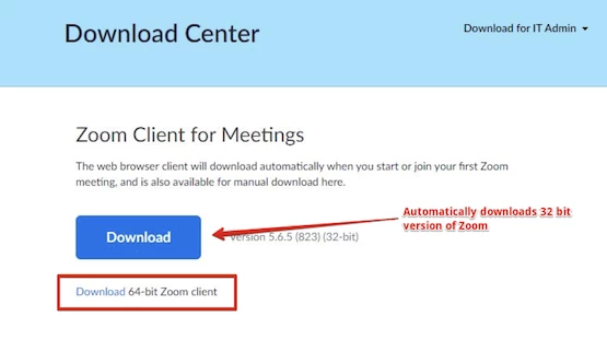

    I got the below response from TS - basically a hard uninstall and reinstall the 64bit version. I do know it is a larger problem as it has started happening since the last update with a number of colleagues. And this is not a coincidence.  It does sound like a bug. But I am going to try the below and fingers crossed it works as it is very distracting having to turn your video on and off etc...
    Hi there,
    Good day to you, I hope all is well. I'm from Technical Support of Zoom and I'm more than happy to help you in any way I could.
    That might be a Zoom client issue. Please follow these steps on how to get the old installation cleared, and get Zoom reinstalled and working for you.
    Please run the CleanZoom.exe application attached on this email and then restart your computer once you confirmed that Zoom has been removed from your machine. Using your machine's default uninstall option from Programs and Features / Add or Remove Programs doesn't clear remnant files of Zoom from your machine.
    Once done restarting, please go to Zoom's Download Center and install the 64-bit version of Zoom client as shown below.
    Once installation is successful, please run a test meeting and let me know what happens.
    Regards,
    Mark
